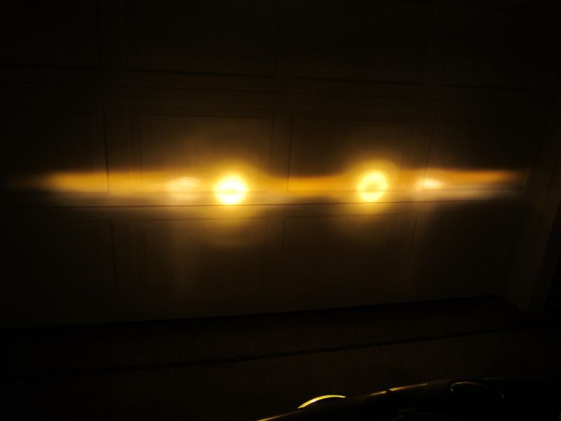

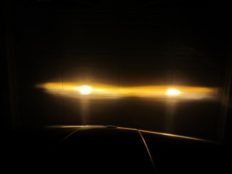

                  a couple quick pics of the light output, in case anyone cares. Granted this is 4 feet from the garage door, but whatever.
                  OEM lows+mercedes yellows
                  OEM lows+mercedes yellows+hella 550s
