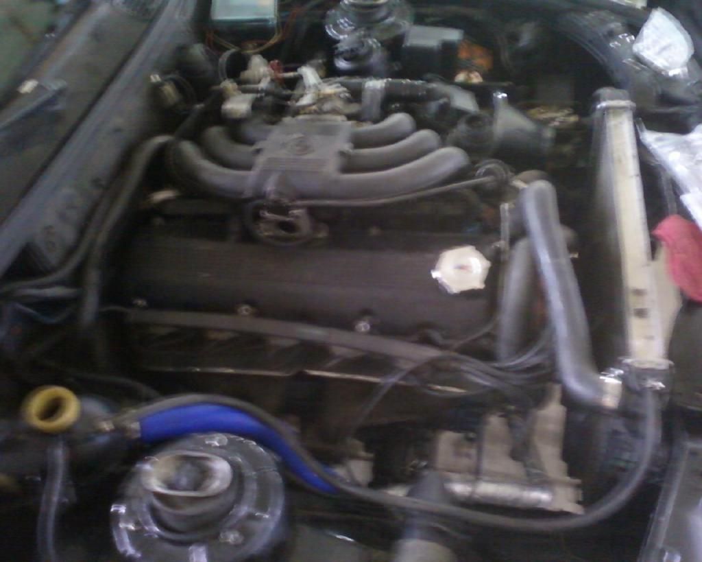

    Going into its home. Getting friendly with the new wiring harness and sensor for motronic 1.3.
    The start of day two had to solve the CID and CPS sensor/bracket problems as well as oil pressure and oil level sensors, starter connector, and a few other miscelaneous problems as well as connecting up the exhaust and driveshafts back up. The slave cylinder was reinstalled (new) as well as the lines to it and the system was bled. Needed to figure out how to route some of the wiring because the motronic 1.0 has some differences and does not have wires going across the front of the engine between the timing cover and pulleys. I also had the bracket/ sensor for the oil sender unit in the block so I switched that out from the same iX I got the wiring harness and ecu from. It lives on to fight another day in this one!
    Then the covers were put on and double checked.
    And finally the wires and radiator/ coolant and oil were added.
    The car wouldn't fire. The starter would click but nothing. It turns out the starter ground was only finger tight. After tightening that and giving a few seconds of cranking fuel rushed into the fuel injectors and the beast roared to life! When I say roar I mean it as that nasty exhaust leak i still there.

    I think the running problem is caused by a bad cps sensor (rabbits and bad wiring) that we figured was worth a shot. The CID sensor may or may not be working, we just put it on there to try to get it going.Without it it double fires and could be causing a backfire/ un smooth running. Thats what you get switching from the motronic 1.0 bell housing sensors to these. I'd like to make sure the injectors are in good shape but mainly glad it is running. Will try to get a new sensor for next week as well as some diff oil and suspensin components. The front end is way out of alignment and a tie rod is held together by a zip tie!!! Also need to put on swaybar endlinks and fix the instrument cluster's tach before it is road ready. Until then, you'll just have to watch the video I posted!
