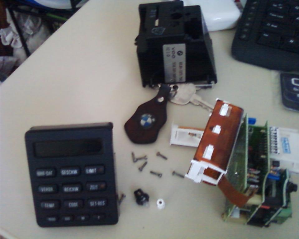

      I also reworked my euro OBC so for the most part it now works. I swapped the back half of a US one to the front half of the euro one. A few pixels don't come on and the light doesn't work, but you can see it working under the dim light!

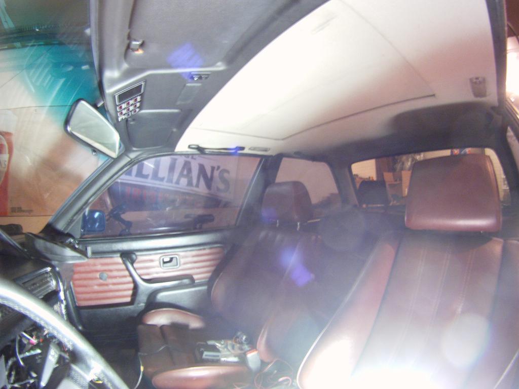

                I got some update for you if any of you are still interested. I pulled the dash out and tried to fill in the cracks. I would say it is an 8/10. When I was putting it back together a few seams split a little. For my purposes it is good enough and I may throw a cover on it if it is bad. I fixed all of the wiring in the dash, cleaned the vents, fixed the broken vent pods, and started fixing the vac panel that was hardly held in place. I also removed some wiring under the dash, fixed the overhead lights so they turn on when the doors open.
                Then I put in a radio that has a color match pretty close to the stock interior. Here are some pictures from the gopro.
                I've got to fix stuff still but it is a decent start.
