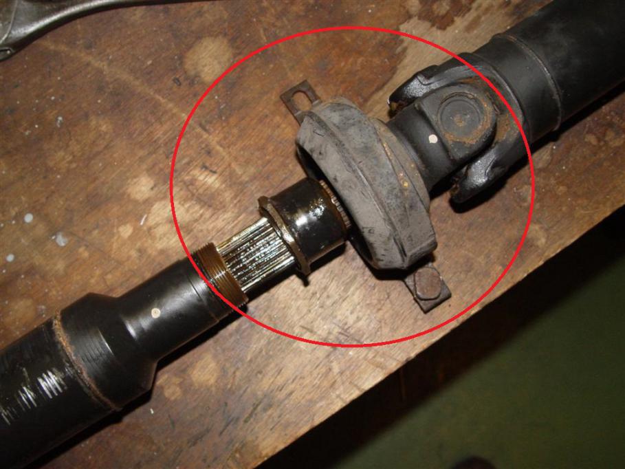

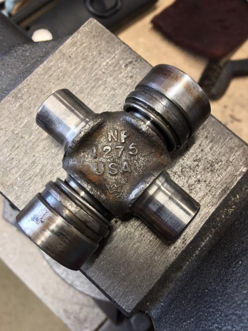

          First carnage of 2020! I acquired a drivetrain clunk, which I found to be play in a u-joint on the rear piece of the driveshaft. This shaft is actually a reman of some sort that I bought used years ago, it has replaceable u-joints. The inner surfaces of the shaft were machined to accept inner u-joint clips. I had the front half of the shaft modified, a 540i flange was welded on to mate with the Getrag 420g. So, I figured I would just swap out the u-joints. But, I don't have a clue what joints they are. The number on the cross (1275) appears to be a Neapco 1-1275 joint. All of the dimensions that I took line up with what is advertised for this joint: inner clip style, clip-to-clip distance, and cap diameter. However, that is an Agriculture PTO shaft joint, rated for 25hp at 540rpm. Lol. So I took it to a drivshaft shop, they seem to think a Spicer 5-105X will fit, even though the dimensions that I measured are slightly off from what I found on that joint. I suppose I'll find out tomorrow when they get the joint and install it.
          I also noticed my driveshaft has become quite twisted.... So I need to look into a front section replacement eventually. Considering swapping to an e46 M6 Getrag 420g output flange, so I can run an OEM e36 M3 automatic driveshaft. If I learned anything on this car, it's that aftermarket and custom parts are generally a PITA. If there is a way to use OEM shit, do it.

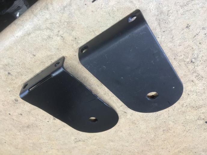

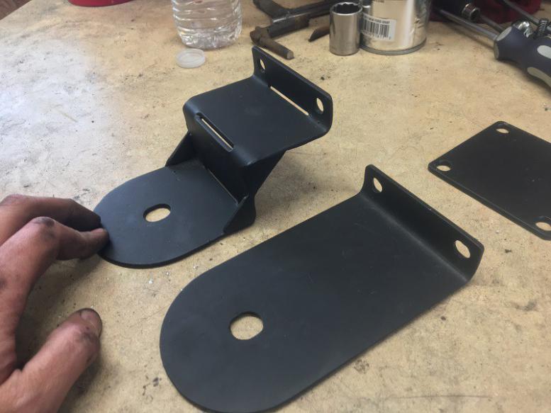

            In the meantime, I got a used driveshaft rear section from a local guy, tossed it in, and all seems well. So if the u-joint replacement falls through, this should work. He also gave me a Garagistic secondary diff mount. It's designed for the Z3M cover, so I had to do a bit of cutting and grinding. The one mounting tab was too short too, so it wouldn't even work with that cover as designed. Not to mention the trunk floor bracket not being resized to accommodate the spacing. I had to add a section to get the proper length. I'll also need to get the proper softer diff bushing to match the other diff bushing. I'm not too worried about it for now, as the steel mounting tabs are only bolted to the body, and there is a layer of undercoating and seam sealer separating the metal. If anything, I bet this stiffer bushing adds less NVH than the softer bushing on the stock mount.

                  The shop was right, Spicer 5-105x fits perfect. 1.00" cap diameter, 1.718" between c-clips.

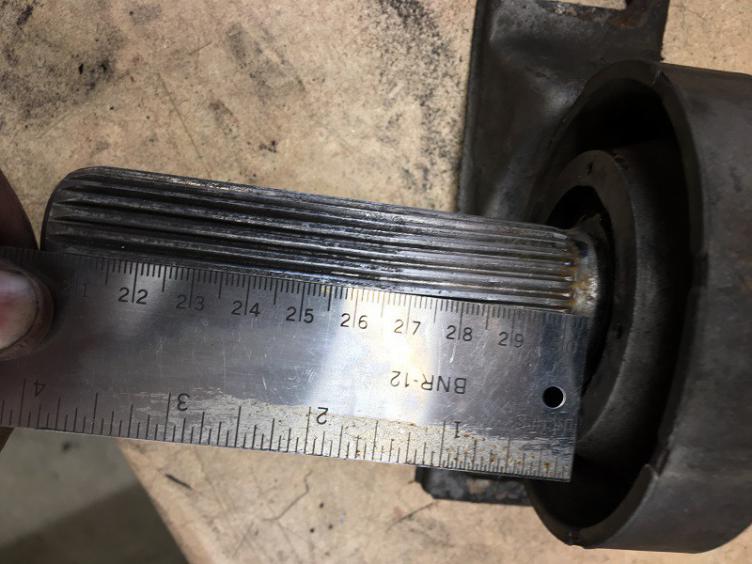

                  The only thing preventing this driveshaft from being a good permanent solution is the fact that the middle splined section is twisting, and I assume it will eventually break. I'd like to find a machine shop that can do the machining required on that middle piece to accept this u-joint. If I could have a couple of those pieces modified to keep as spares, I'd feel a lot better about this driveshaft as a long term solution. At that point, with removable u-joints, I could just replace the center section every few years as needed.
