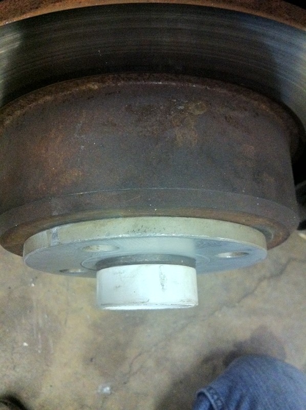

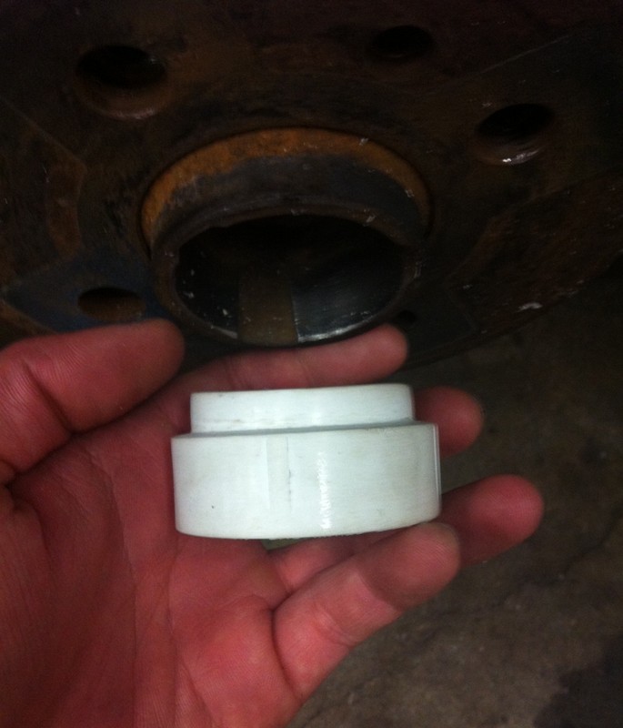

                            Today I made some hub extenders. As we know, if you want to use a spacer 8mm or bigger, you cover up the area of the hub that centers the wheel, and you could get vibrations. Once you get to 14mm or so and above, there is enough material in the spacer to add a lip to make the spacer itself hub centric. This leaves spacer sizes of 8mm-14mm basically unusable unless you like wobbly wheels. I wanted 10mm spacers, so this put me in a bind.
                            So, I made a set of hub extenders which press into the hubs, and are 57mm OD, for the wheel to center on.
                            Before:
                            After:
                            e30 restoration and V8 swap

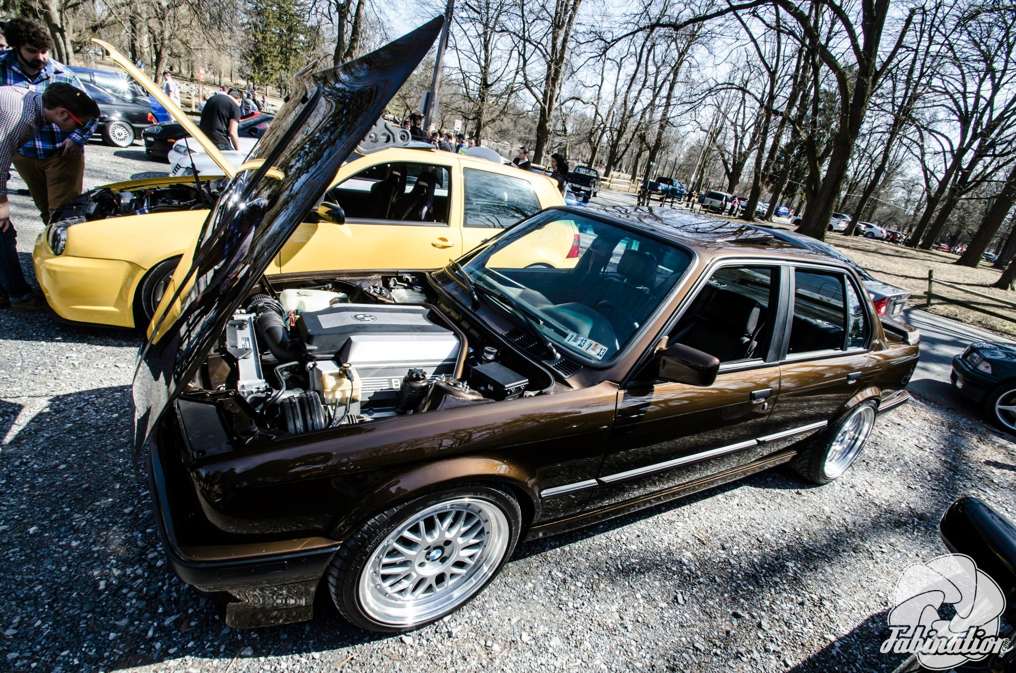

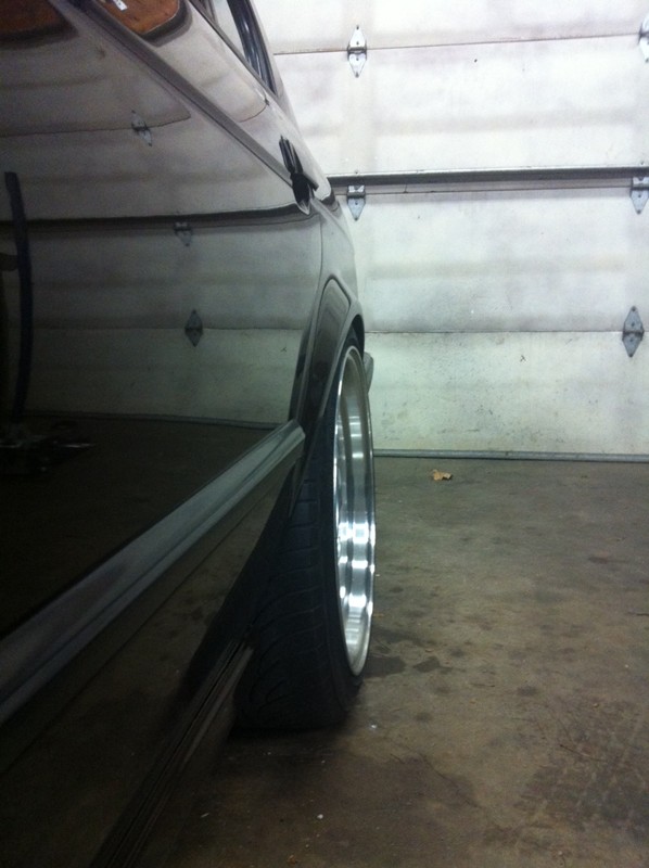

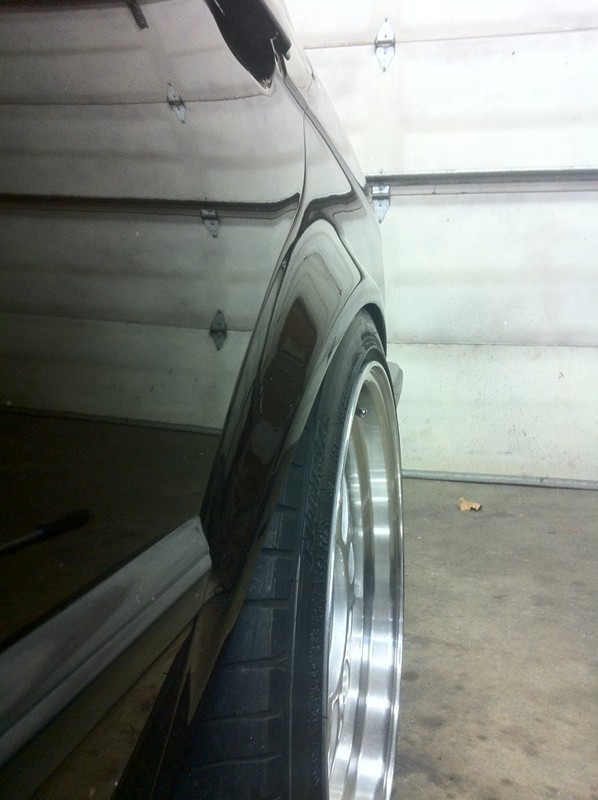

                              Had a fun weekend with the car! Ultimate Klasse photoshoot/feature coming soon :)
                              (HIGH RES)
                              24 Hours of Lemons e30 build
                              • MR 325
                                • 37827
                                #765
                                Fuck yeah! Absolutely loving it over here man. I need a V8 E30 now.
                                Looks beefy with those spacers installed! Love the paint matched strut brace too.
