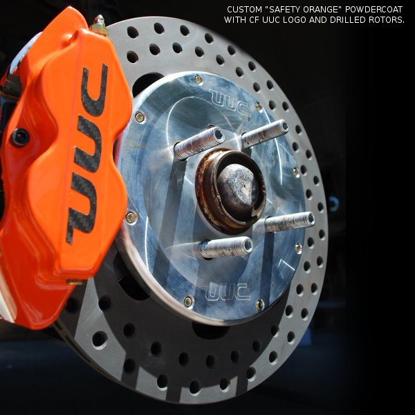

                          UUC was having a sale so I bit the bullet on the BBK with drilled rotors,black caliper, light track pads and SS brake lines. Tough choice for me, I was going to go with the IE kit but this was cheaper, weighs less and will definitely help fight my brake fade.
                          7speedshop.com
                            Great choice on the BBK! Can't wait to see this car in person sometime.
                              I'm sure you can tag along on our bimmer fest cruise :)
                                Awesome! You'll love the brakes!
                                Did you go for the street pads? That's all I'm running.
