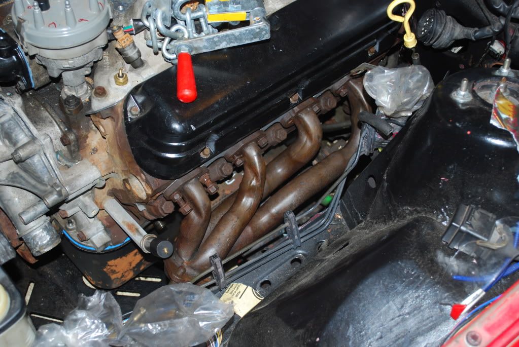

    Got the headers on, but unfortunately I need to order a remote mount oil filter kit. I measured and for some reason though I could get away with the small one I bought, but turns out theres no way to make it fit.

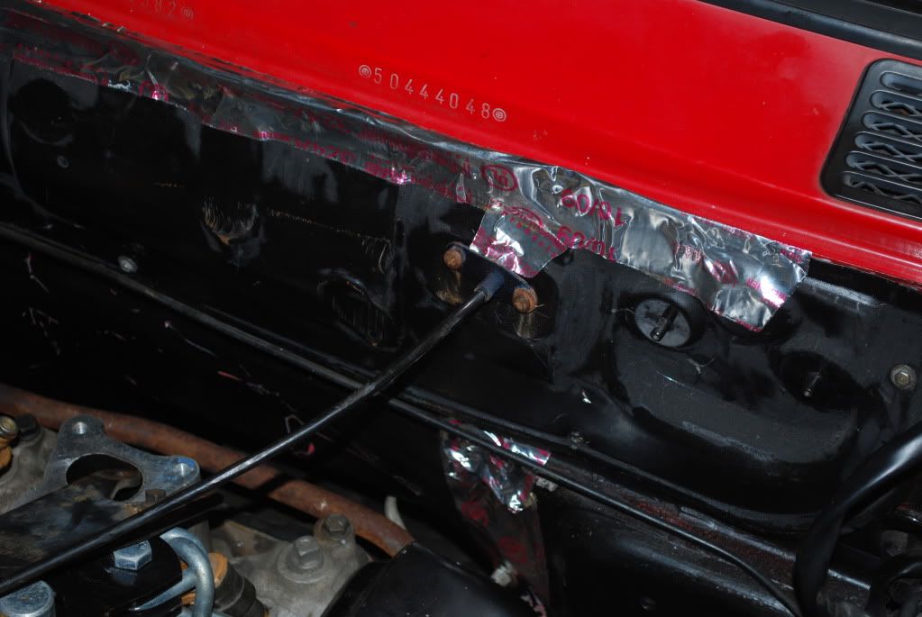

    Got my gas pedal mounted (excuse the tape, temp sealant)

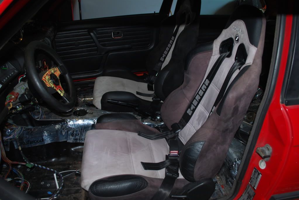

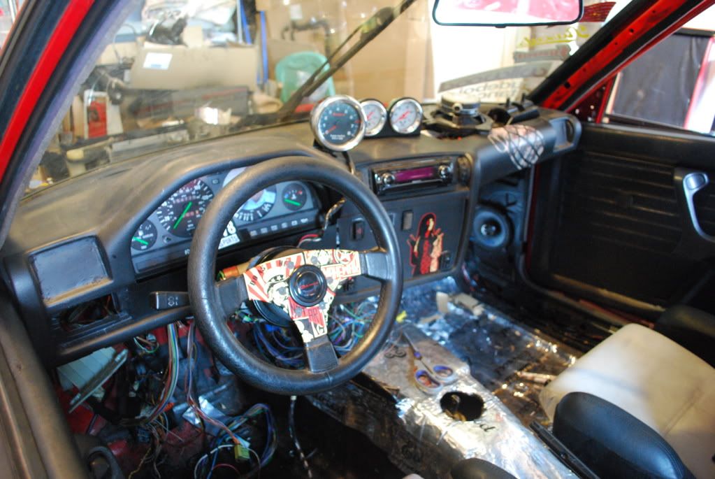

    Got my interior finished!

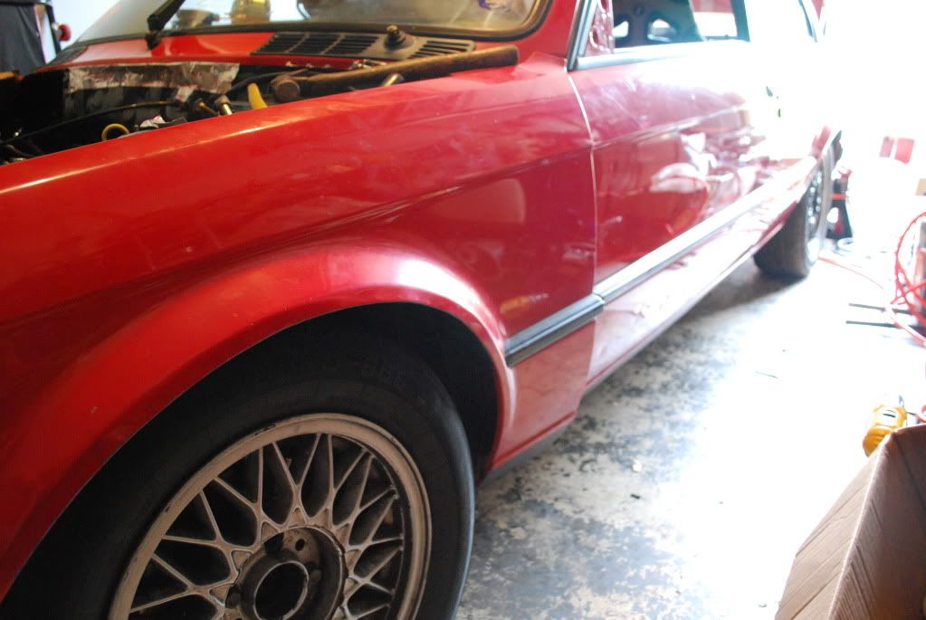

    Did the small fender mod to gain some wheel/ tire room, and help give the hot air off the brakes to exit:

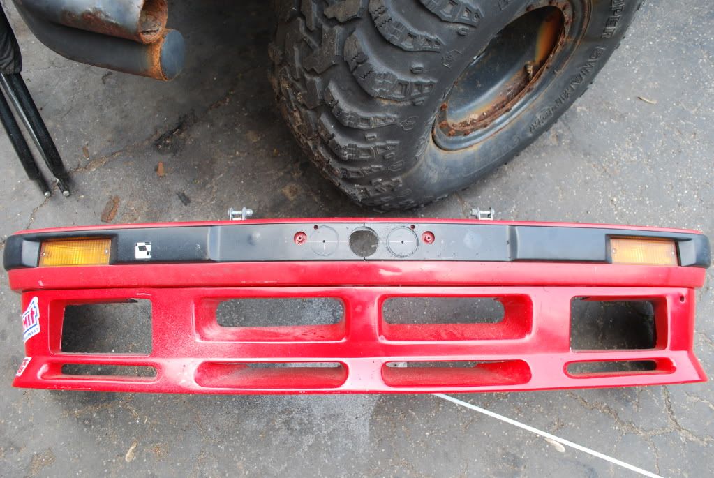

    And I've been hearing some people are having cooling problems with the swap. Solution? Racekor holes in bumper!

          The fender looks absolutely ridiculous.
            I know. Ive since attached it properly. The only way I think it can really be done and look decent is with side skirts.

              The oil filter is why i went with it ran up. Was going to see if the e30 oil cooler fitting would thread onto the 5.0 but realized that would defeat the purpose of having an oil cooler because it would have to pass by the header anyways. It would point the filter away from the header tho.
              Also i went with a merge and flange just before the subframe so i can drop the entire front section as 1 piece. Then snaked the 3" mandrel back under the mount and around the starter. This allowed me the ability to keep some flow and remove the pass mount and header to take that portion out to finish weld it (cant weld it all the way around even with the starter pulled out) and wrap the pipe in header wrap so i dont cook the steering rack and starter.

                Hmm... Good to know. And actually, the reason I tried flipping the headers was because I saw what you had done. Problem is, it gets right in the way of where my remote mount boost/ MC setup will be. So I gotta bite the bullet, and buy the remote mount oil.

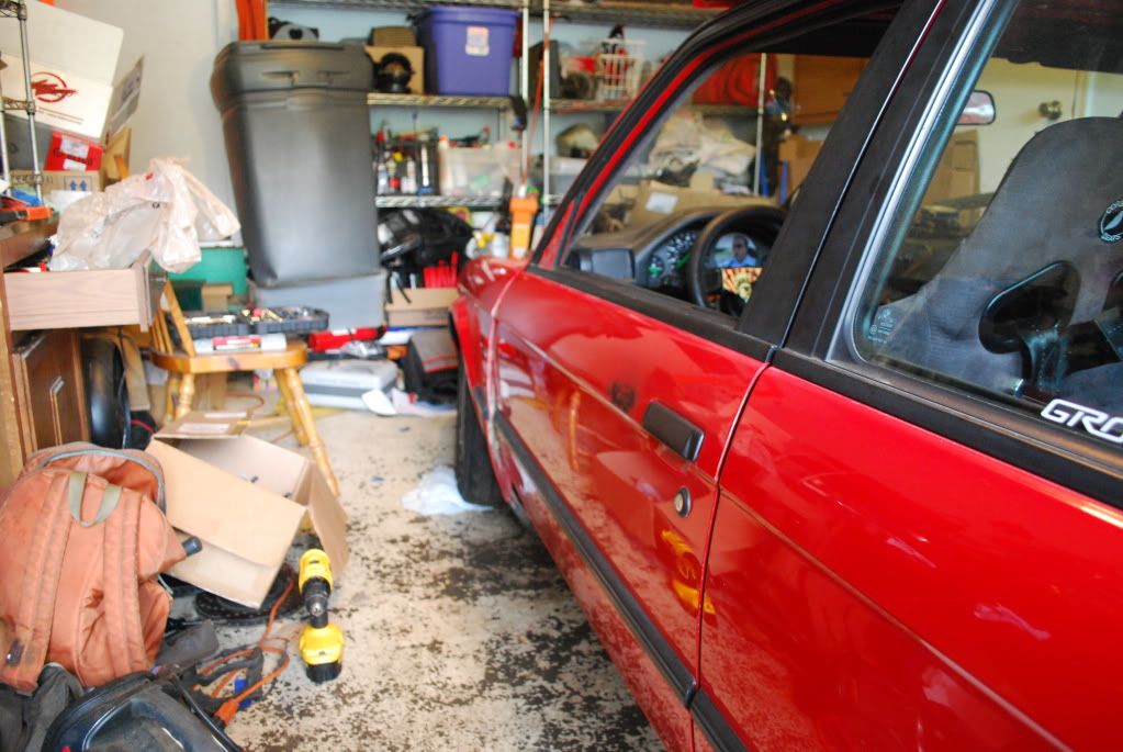

                        Correction, my FRIENDS parents must be po'd right now. Though that is seriously ALL cleaned up every time after were done working on the car.
                        The ladder? I believe my buddy was cleaning out the gutters.

                            Sometimes I look at updates I haven't seen and think "Wow, he's really got that thing on track" and then invariably I see something like the switches where the HVAC should be and I know it's still the same ol' Funfgan. I really do enjoy trying to ridicule you but I do admire your spirit.
                                Who needs an hvac panel anyway?
