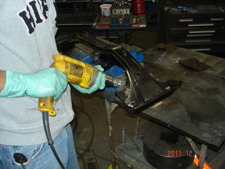

                            Got my subframe sandblasted and reinforced! :)

                              Great work

                                I did the same thing w/ my subframe!!
