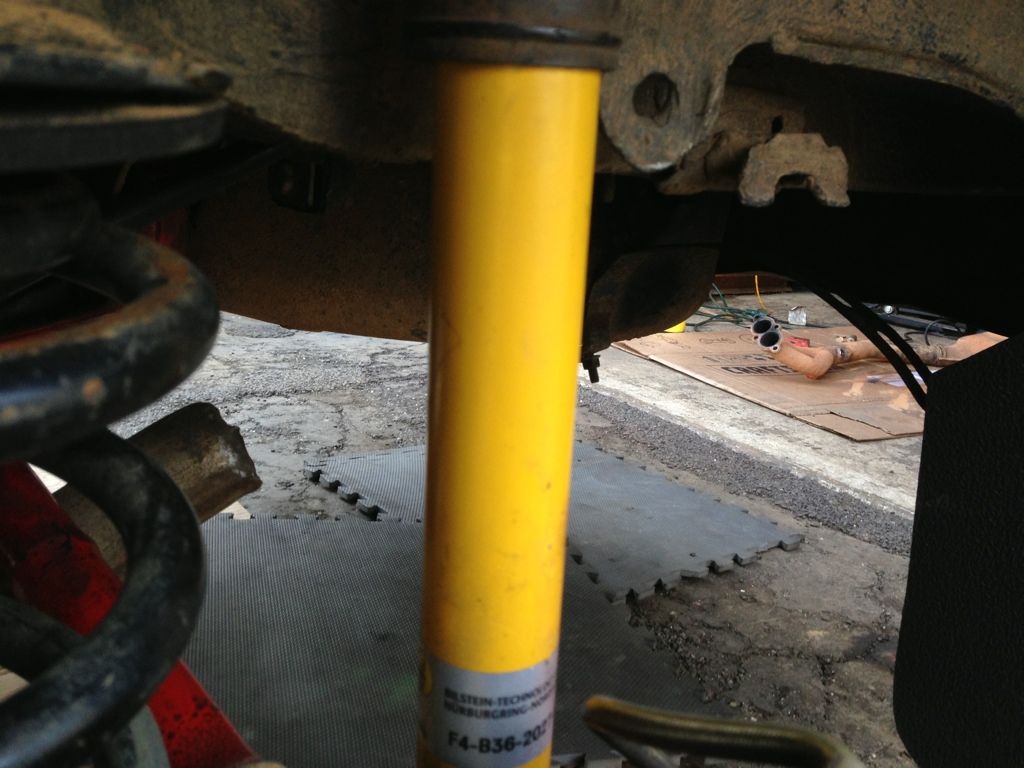

              Also was able to start on the front suspension, however I was cut short as it started to snow and ended up with a little over an inch of snow by the end of the night... with only more to come supposedly. I pick the worst times to do suspension work.
              I did the same. It was so cold doing my Condor M3 CABs that I gave up after 1.

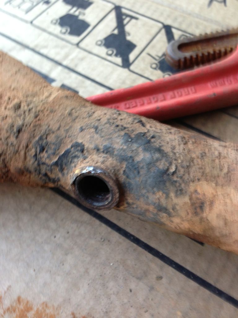

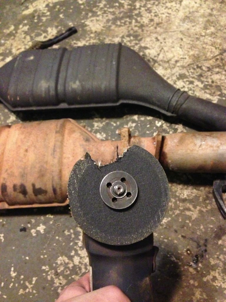

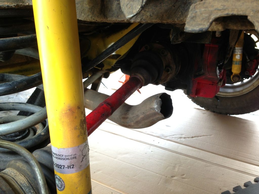

                        Since I'm back at college, its really hard to work on the car since I only come back on weekends.... However, I should be driving it tomorrow and take it to college to work on where I am living. Did a couple things this morning with the exhaust and such...

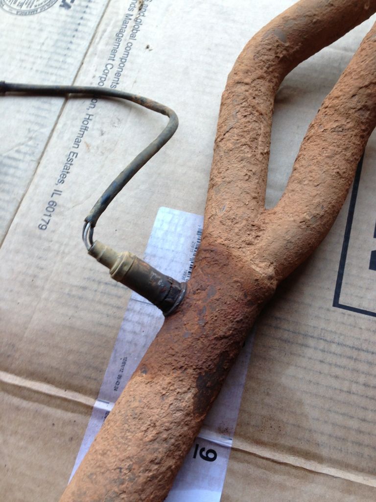

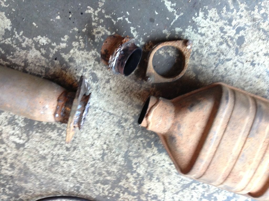

                        Since the exhaust was one whole piece (the front and cat-back was welded together), I had to cut them apart in order to use my new front section. Started off by using what I guess was a damaged blade which shattered after about 5 seconds of cutting.
                        Got them apart and ground down the rear section so it can slide on to my new front section I got with a spare m42 I have.
                        Also had trouble with the o2 sensor which I ended up stripping out when using a pipe wrench and heat(also soaked in pb blaster the 2 nights before) to get it out. Going to be looking for a new one.
                        Any suggestions on a muffler to put on this thing? I want it to be throaty, but not too bad at WOT.... m42s with 4.10s get annoying at 3.5k cruising for about an hour and a half(my drive to summit point). Right now it has a stock cat with the stock resonator deleted(has a small little 8" one in its place).... just need a muffler. I think a glasspack would be too loud.

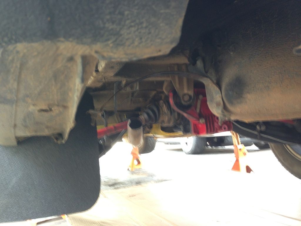

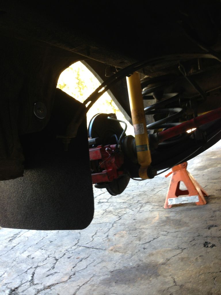

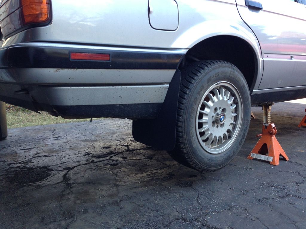

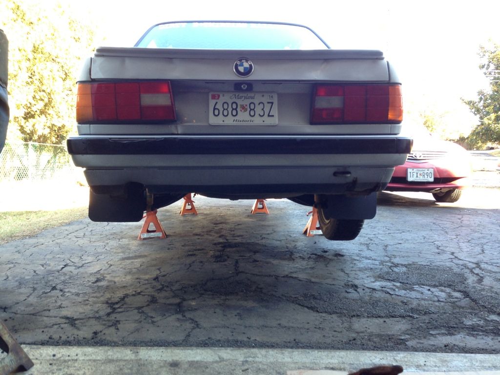

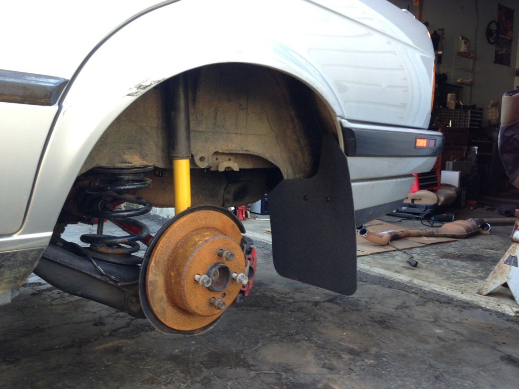

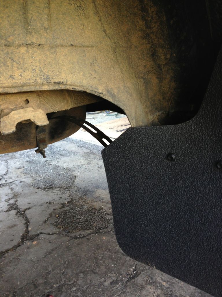

                          Also made an attempt at test fitting the KaMotors mudflaps(the rally versions). The rear design should hold up pretty well. Going to make 1 or 2 more mounting points for the fronts though.
                          My only concern is on the exhaust side where the flap will be somewhat close to the exhaust... I might have to cut the flap a little bit just so it doesnt heat up the flap too much. Some pictures for reference:
                          I'm going to fit the fronts later in the week after I get the exhaust and rears done and mounted nicely.... they do look pretty cool though. Thanks KA. Might buy another set for my other car.

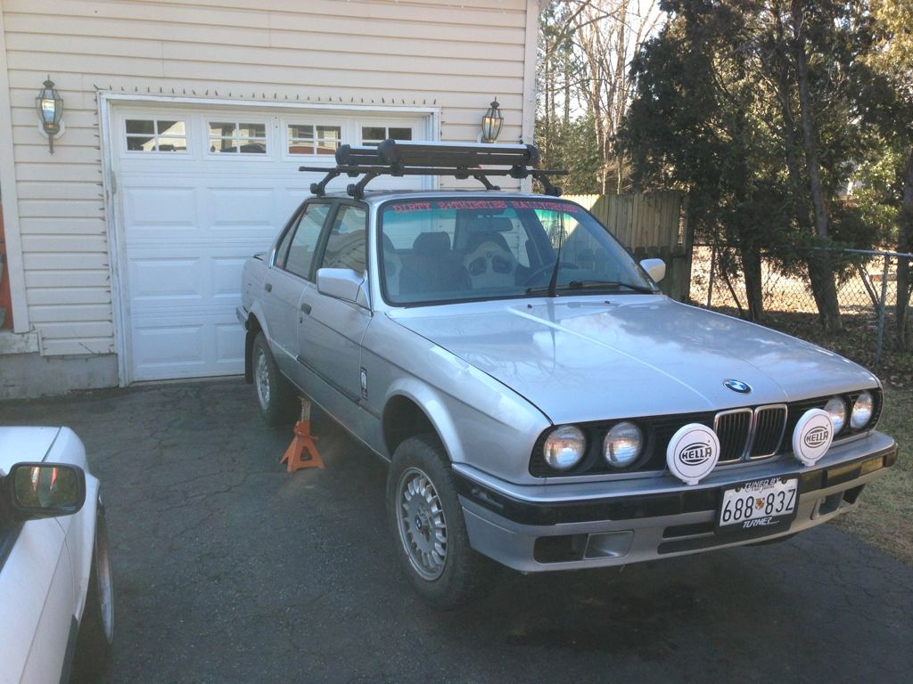

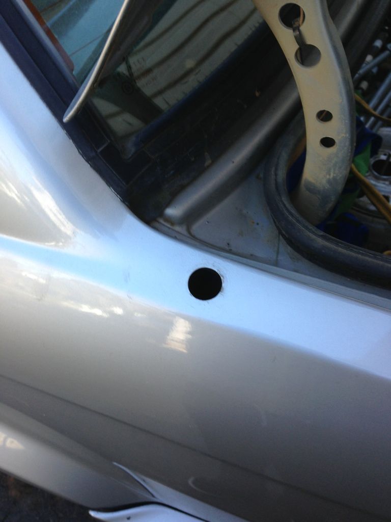

                          The last thing was taking the old antenna out and putting the delete plug on. I only test fit it today because I want to wait until its a little bit warmer(or get the car in the garage) to use the sealer so it can dry a little better. Going to use the same 3M windshield sealant I used for the diff bushing to seal it.
                          Also transferred my trendy roofrack over to the car from my other e30. Super trendy ultra rallycar points acquired. But I actually do use the rack a lot as I go snowboarding quite frequently.

                            yes trim up that muffler side, I leave it big because some cars use magnaflows, others use glass packs and some use stock so I just trim it enough to clear most setups but not all setups.
                            your cars looking great
