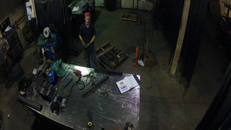

                    Good guesses. The correct answer is.... Tubing Bender!!
                    After not finding a good used one locally and not wanting to pay out the a$$ for something I will only be using to make one roll-cage for, I decided to make one following a set of plans I found online (Also known as the Go Trikes Bender). A few key elements that I really like about this bender in particular is the vertical bending angle lets you easily measure your bending angle as you go. Another plus is you don't need to support the far end of the tube on larger pieces, like you would with a horizontal bending position. It also runs off a pneumatically controlled hydraulic cylinder, so there's no need to bolt it to the floor or use a huge breaker bar like you would on most cheap, manual benders. All in all I have about $100 in parts (not counting the dies). Not to shabby considering it's only two days of my time, and it's something I enjoyed making.
                    This also gave me another chance to use the GoPro for a timelapse movie. I think the stationary camera position makes the video much easier to watch. FYI, there's no audio on this video. I got lazy and didn't feel like finding a good song lol. Oh, and you'll notice that the video stops before it's fully assembled. That's because the battery ran out lol. Looks like I may need to get the extended battery pack or remember to plug it in before shooting.
                    In this video I'm fabricating a tubing bender that will be used to make the roll cage and other small misc parts on the 2002. With some help from a friend,…
                    And here are some pictures of it mostly assembled. I still need to paint it, but I'll get that done here in the next week or so.
