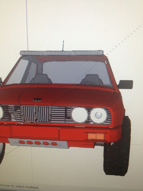

              Next thing I want to get is maybe a 40" led light bar for the roof,mount it kinda like this

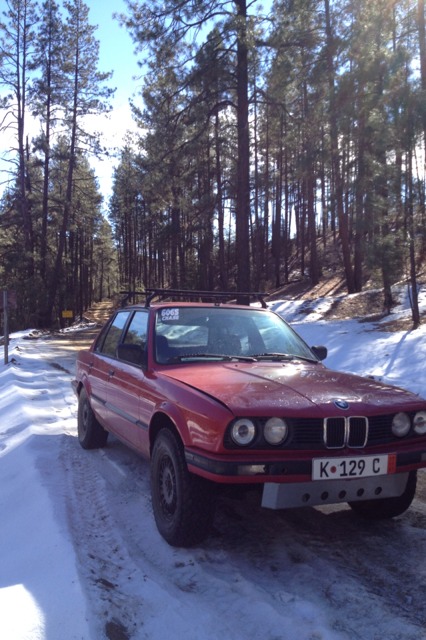

                    Took it out to the snow today
                    Found a nice fast road, grabbed some lunch in Prescott made it home fine. Just went to leave and the fuel pump died :( Better in the drive way than in the cold but wtf
