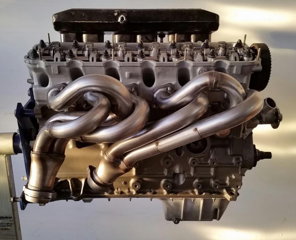

                                WANT.. Frank had 2 of the new Racing Dynamics long tube hearders left last year and I passed. I'm on the list for the next batch of 6.
                                Note his old dbilas plenum on the top of the pic :-)
                                re the inevitable midrange torque drop, i'm thinking the SC + MS combo will allow me to completely flatten and raise the torque curve. We'll see next year.
