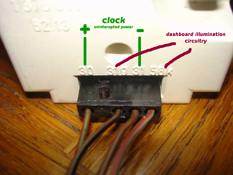

        finally installed the IX mirror and my euro clock. mirror connected to the light by the check panel, and I tapped the 4 clock wires into the OBC harness. Nice, clean and fully reversible. Clock worked perfectly once I plugged the cluster back in.
        for anyone looking for the wiring to the euro clock, it's 4 wires from the 6/12 button OBC harness you need to splice into. connector you need is the same as used for the mirrors.
        here are the pics you need from here and specific splicing instructions edited a bit for clarity and completeness:
        Originally posted by bmw325csi
        Once you remove the [multifunction clock or 12 button OBC] you will see a harness which has about 12 wires, you only need 4.
        The analog clock has a # above each pin [and if it came with a euro clock pigtail these are the wire colors on it]
        30-power [red-green]
        31-ground [brown]
        58k-illumination power [grey-red]
        31g-illumination ground [brown-black]
        So what you need to do is grab the [multi-function] clock [or OBC] harness and [splice into] these wires:
        red/white-power
        brown-ground
        gray/red-illumination power
        brown/white-illumination ground
