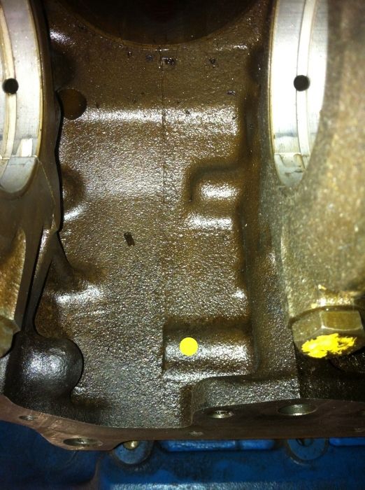

    Originally posted by Denny
    Man now that's what am talking about!! THANK YOU :)
    Pleased to help. I am just learning photo manipulation. Exit is here:
    Lorin
    The M30 is God's engine.
    • Denny
      • Jan 2010
      • 822
      #212
      Originally posted by LJ851
      Denny, i went downstairs and shot a pic of the backside of a M20 block in the area you are considering for oil drain. I think that the spot you chose would work great, it is behind the boss on the lower right corner in my pic directly to the left of the main bolt with yellow paint on it.
      Edit: Your drilling would enter through the boss with the center of the hole in line (horizontally) with the edge of the oil pump mounting boss right below it.
      Right on! Looks like the PERFECT spot!!
        Indeed.
                4 days is plenty of time to drill and tap a hole.
                LOL... It would of been if I wasnt busy 3 of those day cleaning vomit and poop from my 3 year old boy!! Poor little guy was sick ..and then well my GF got sick too so busy with the family!! :( but I found time to still finish it
                Originally posted by codyep3
                this is seriously my favorite builds on here. Group B broseph
                Wow Thanks my man...thats a big compliment! Some dont seem to think my build is that great judging by my 3 star thread LOL!! somebody actually gave me 1 star!! lol...
                Originally posted by Cronopoulos
                I can tap multiple holes in 1 night!!! :nice:
                Awwwww yes those holes are easy and a lot funner :D
                Tonight I finished her up with the new drain...I love this location as it will never be under oil and I reused my fitting I built. So tomorrow am going to get some new oil and start it up.
