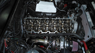

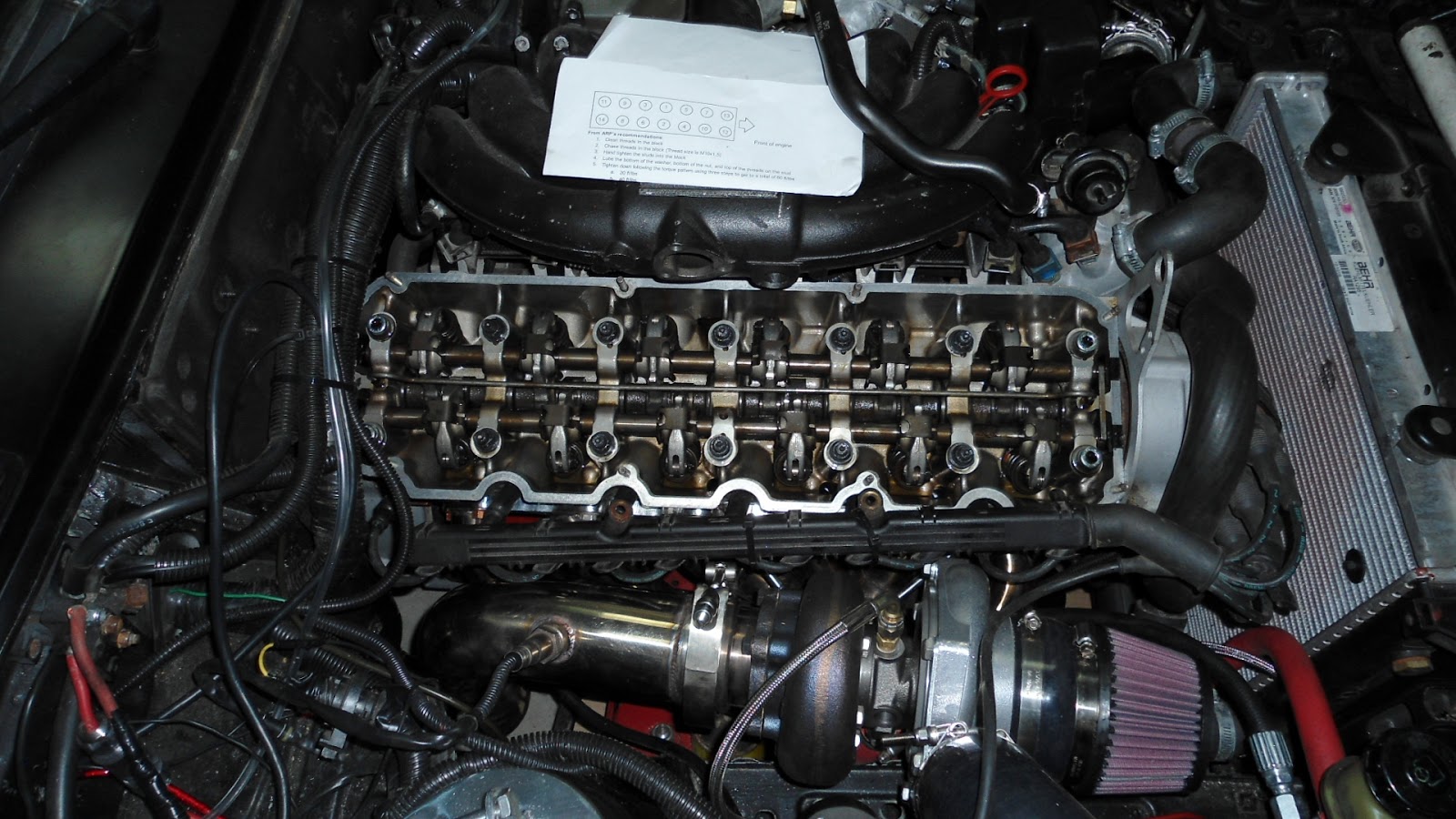

        Few more things done.
        DEKA 60# injectors are now installed along with a good starter tune from "Kamotors" the car started right up but was very lean so I will have to tune tune it from scratch basically my engine has a lot more airflow because of the supercharger. I got the car to idle at around 13.9-14.5AFR at 1350RPM so far.
        I also finished the day with my ARP headbolt studs to 60# torque...tomorrow I will bring the engine to temp and let her cool down a bit and retorque final to 65-70# torque.
        Getting very excited to start driving her... road insurance starts on may 1st :)
        * Please ignore the pathetic little K&N filter...LOL... they sent me the wrong one and I refuse to use the chinese one I bought that I found loose mesh inside..
