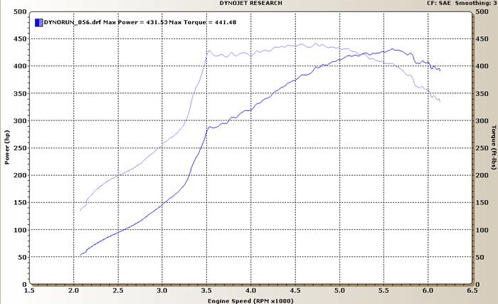

                          ***UPDATE***
                          BIG NEWS got to the dyno finally to do some spark tuning and see how 17.5PSI with 14 degrees would work. Well good news... made over 400HP and the torque is unreal at really early RPM.... bad news my clutch is burned..I started dropping at 5K high RPM realfast so we stopped. But the car is a beast.... overall am happy. Now I need a clutch any recommendations? street/strip not too expensive...???

                            #418
                            Good lord. You have 200lb/ft at the wheels at 2500rpm and over 400 1k rpm later. That thing has to pull like a freight train.

                              #419
                              It pulls like anything I have ever driven before. The torque kicks in so fast its rediculous...17-18PSI in less then 1 second... scary as f*K to drive.. now I need a clutch and wheels and tires... Damn it it never stops :( oh and more brakes... damn boost addiction.
                              Guy at the dyno was shocked...he tought I was some ricer trying to be show cool with a twincharged system...LOL... plus I got about 8 PSI in the bank that I can unlock with a twist on the BLV... god forbid
