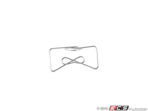

                        So... Last night, we started to mount the trans up to the engine, got as far as getting in the new pilot bearing, mounting flywheel, clutch, Pressure plate, pivot pin, shift fork and TOB and realized I don't have the little metal clip thing.
                        This:
                        SOB.
                        Called my local dealer and can have one tomorrow morning but still it was frustrating. So then, we ate some Jack in the Box.
