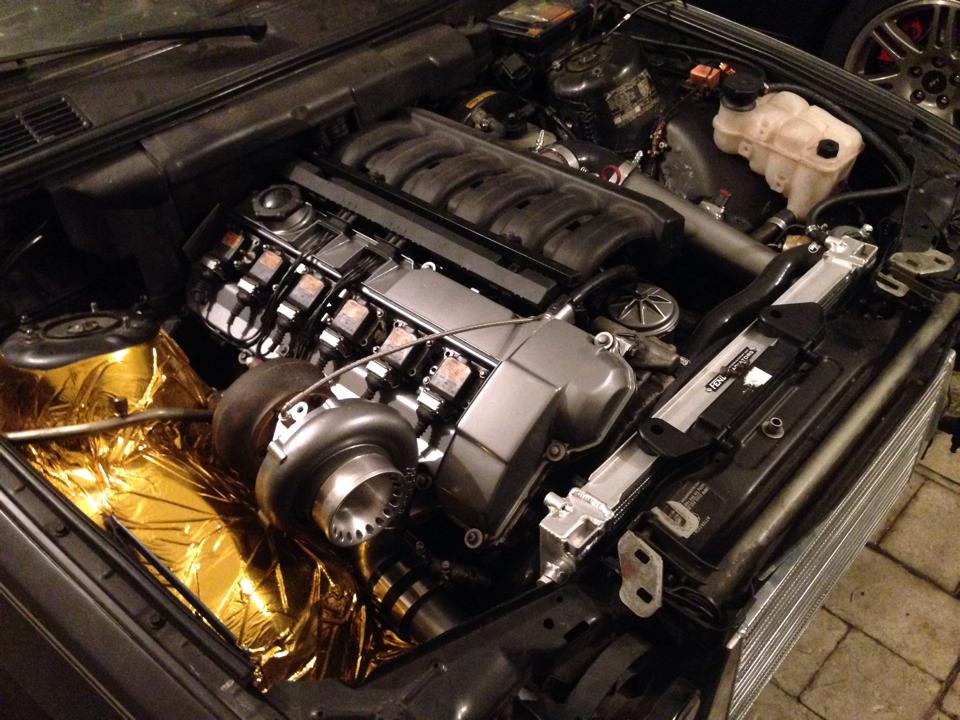

    welded 3" v bands on both housings, Im going with the .82, but I want to see the difference with the .63a/r
      Are you not worried about heat transfer to your ac lines?
            used the stock wrap, and DEI heat wrap around, hope it can handle it

              piping done
                aaaaaaaaaaaand it's alive :D:D
                https://www.youtube.com/watch?v=xyMH...XTXn2IeyaLiilw
                still need to fabricate the exhaust, install the radiator, and front wiring of lights, front valance, bumper etc
                  making space for the downpipe

                          the hood is back on finally! but now Im having problems trying to fit the front valance... hope everything fits
                            Looks great. What size piping did you run to the intercooler?
                            IC dimensions?
                            I may have to try to copy your IC placement but I'd like to hear if it's 2.5" or 3" under the headlights.
                                IC dimensions?
                                2.5" piping from turbo to intercooler, and 3" from intercooler to throttle body
                                Intercooler is 21"X9"X2.75"
