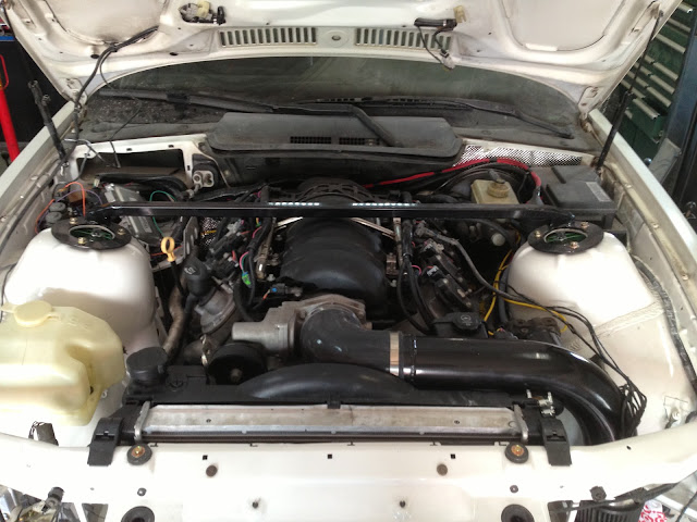

    Intake pipe all welded up
    Went to start it yesterday but didn't have much luck. Fuel pump was running, good fuel pressure but the plugs were bone dry. A little digging and asking some people and I found out I needed to disable a starter diag in the tune. Changed that did a write entire on the tune....and bamn!!
    There is a *slight* exhaust leak at one of the vbands off the header. Just needs to be tightened up a bit more.

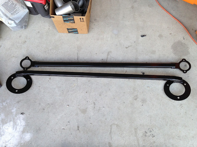

                  Wrapping up little things before it's first drive.
                  Made a front and rear strut brace and had it coated.
                  Had the intake pipe coated
                  Bleeding the brakes and clutch today took hours......just lots of air to get out. But all is working now as it should.

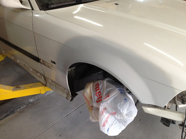

                              Self etch primer on all the bare metal spots.
                              Flares now have the first coat of high build primer
                              Engine bay almost done.....
