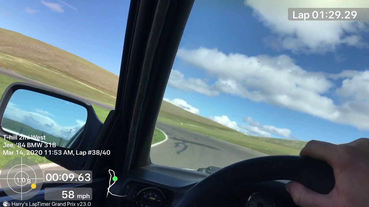

                  I did another track day at thunderhill west and managed a 1:27.That's on 4 year old Hankook RS3s so there's definitely more in it, I think it could manage a 1:21 and 1:22 with the right setup changes.
                  I'm pleased to say this time it went much more smoothly. The coolant temps stayed right at 200-210 and oil temps 220-240. Last time out cooland would creep up to 240-250 after 2-3 laps and oil was solid at 260. Coolant temps measured at the head. Must've been the timing.Towards the end of the day boost was creeping up to 11-12 instead of the 8psi it was supposed to be set to. Seems like there's something broken with the boost controller.
                  I definitely need to add more front camber and do something about the understeer. Also the car has bad oversteer on corner entry, and the brakes are bad all around. The jetta brake booster doesn't provide nearly enough assist, Im having to really put weight into the pedal to get the car to slow down, even with Hawk HT-10 pads, which are pretty aggressive pads.
                  I'm pretty bad about updating this thread even though there's a lot going on. I blame the tapatalk app being trash now and this dumb forum update.

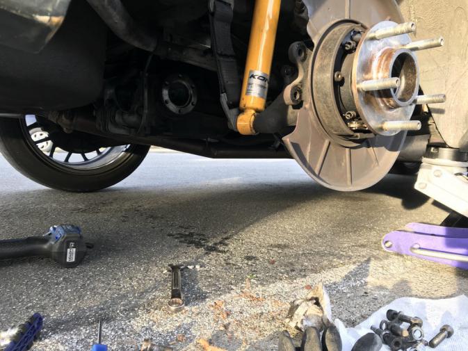

                  Here's some pics of new axle going in. Still need to do the other side, but if it ain't broke, don't fix it.
                  Click image for larger version  Name:	UNADJUSTEDNONRAW_thumb_265.jpg Views:	0 Size:	67.1 KB ID:	9912119

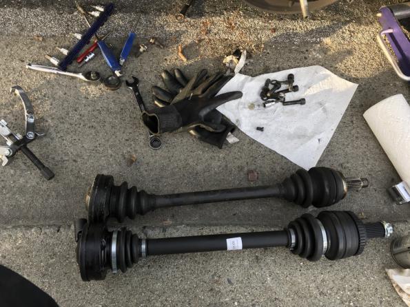

                  New vs old
                  Click image for larger version  Name:	UNADJUSTEDNONRAW_thumb_266.jpg Views:	0 Size:	61.8 KB ID:	9912120
                  It was a bitch to get out the old one. It had totally seized and a 5lb sledge didn't even touch it. Ended up using a big 3 jaw puller to press it out.
