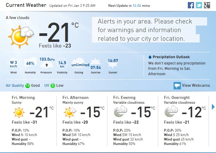

    #91
    #canadaproblems
    I couldn't imagine living in Winnipeg, their average temperature for the month of December was like -20C, on new years eve they set a record low of something like -38C before wind chill.... and when it's not an arctic tundra there it's a flooded swamp full of mosquitos..... FFFFFF that lol
