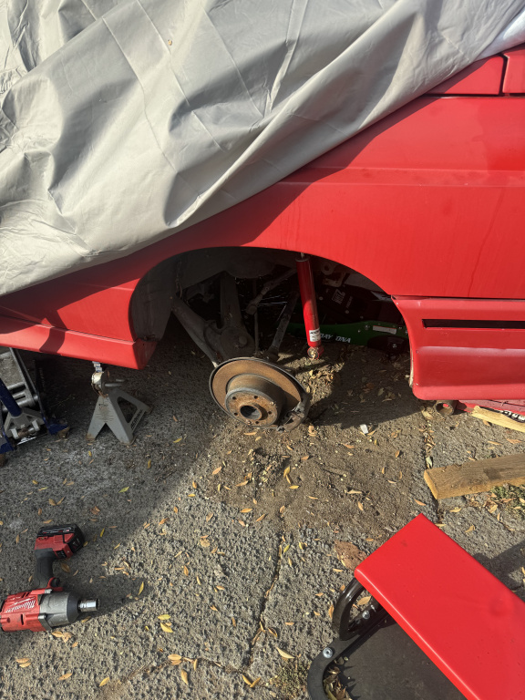

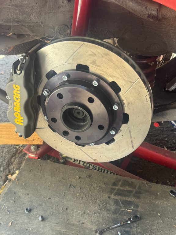

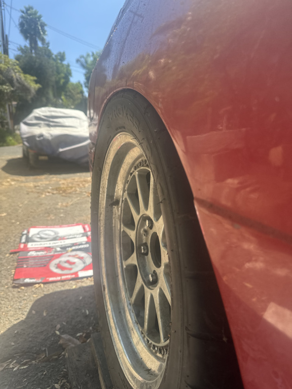

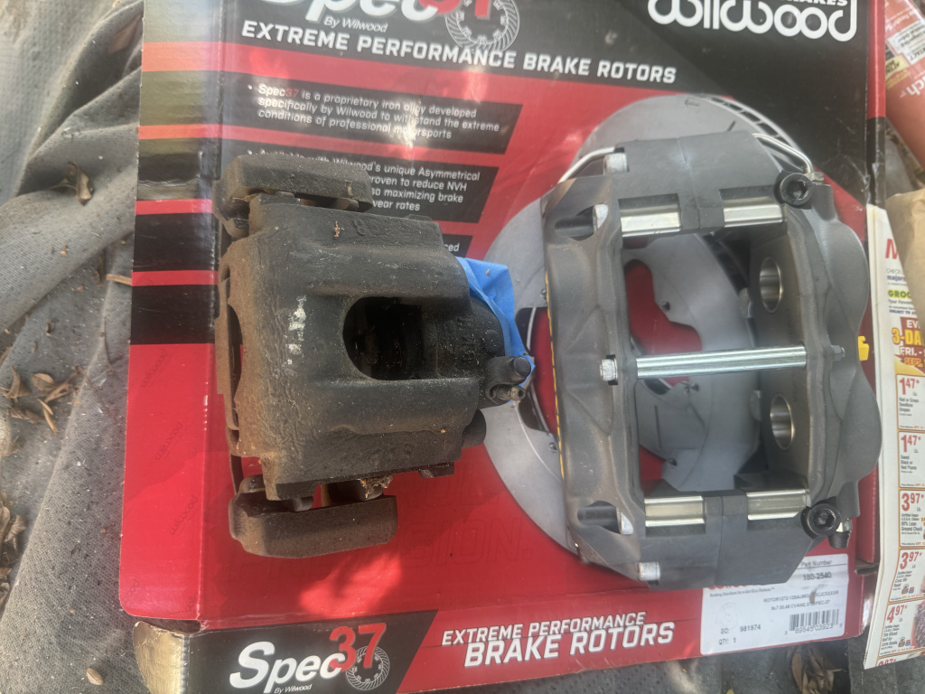

I wanted to see how much camber I needed to clear from out side fender. I went under the to see how much room from tire to shock. I have a 13mm of clearance. That gives me good news I can clear away from out side fender. So The AP caliper are close to Hartge spokes. I still feel confident they will not rub.I finish up on the AP brakes on rear before I take the rear subframe off
to put on bushes and add adjusters.Projects Hartge,Alpina & AC Schnitzer Builds.http://www.r3vlimited.com/board/showthread.php?t=280601

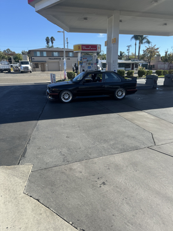

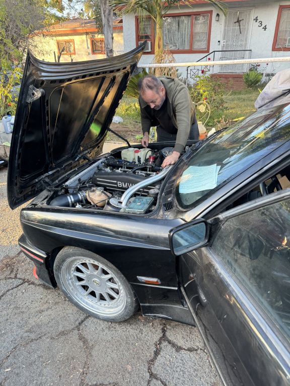

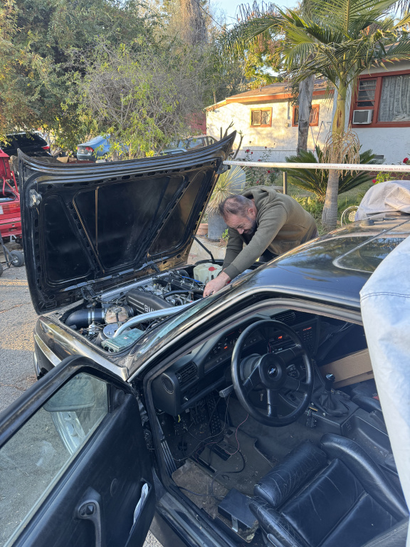

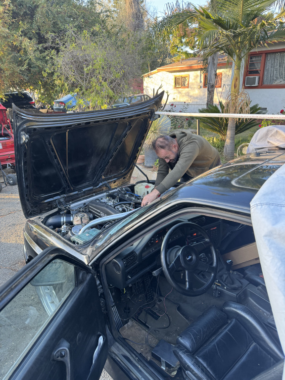

I had my friend Maro come this to help me with the blk M car.

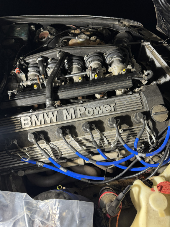

He diagnosed four problems on the m88/3 motor. The intake boots were cracked, the white relay to ecu was bad, the Nology 8mm were spark plug wire in bad shape after 20years and I had two injectors were not working. Maro tapped the with a screwdriver. He got them to work. I ordered a new set of injectors.Projects Hartge,Alpina & AC Schnitzer Builds.http://www.r3vlimited.com/board/showthread.php?t=280601

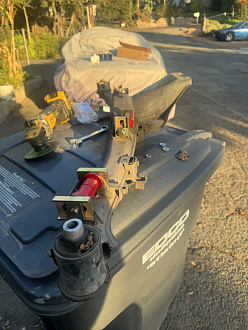

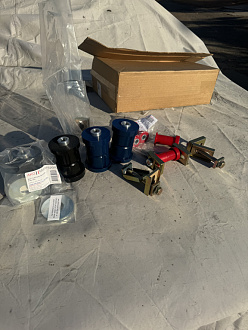

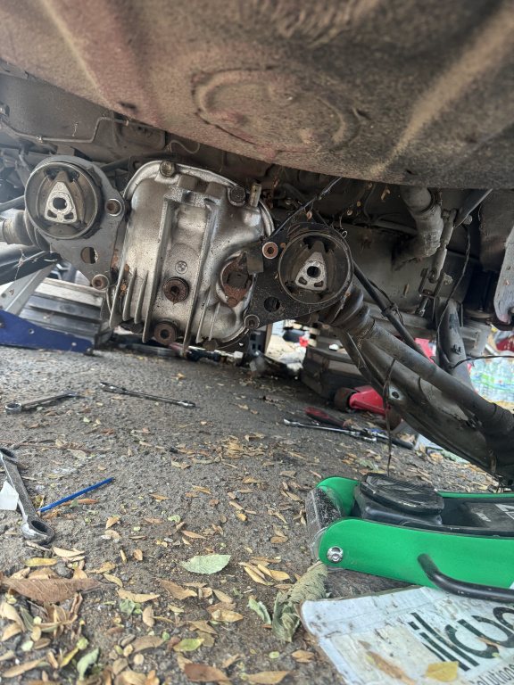

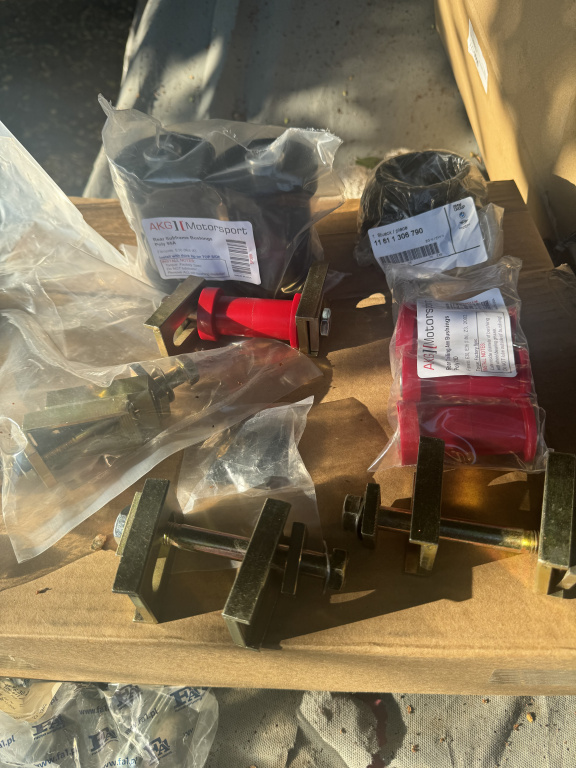

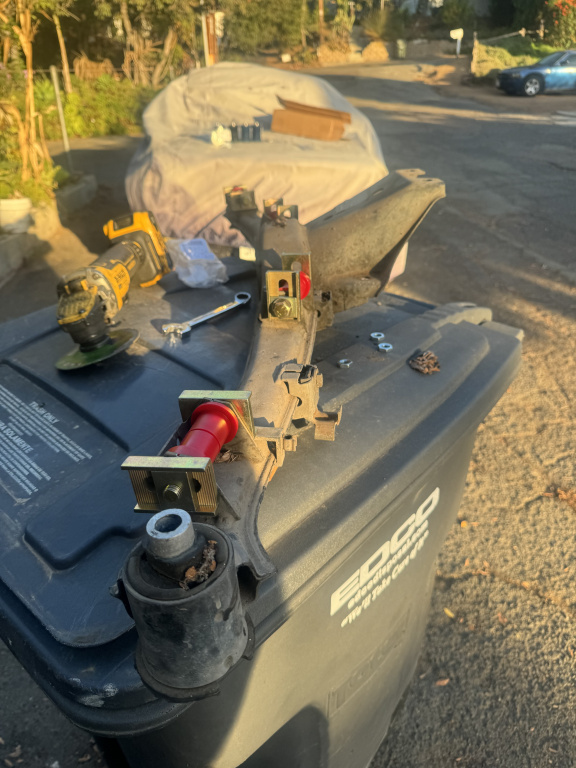

I been researching on rear subframe bushings. I was going to use AKG 95a subframe and red 75d controller arms. I wanted oem bmw solid diff bushings. I can’t find them. I recommend from by Ryan C to buy AKG. Im going to order this week blue 85a subframe and daul diff mounts.

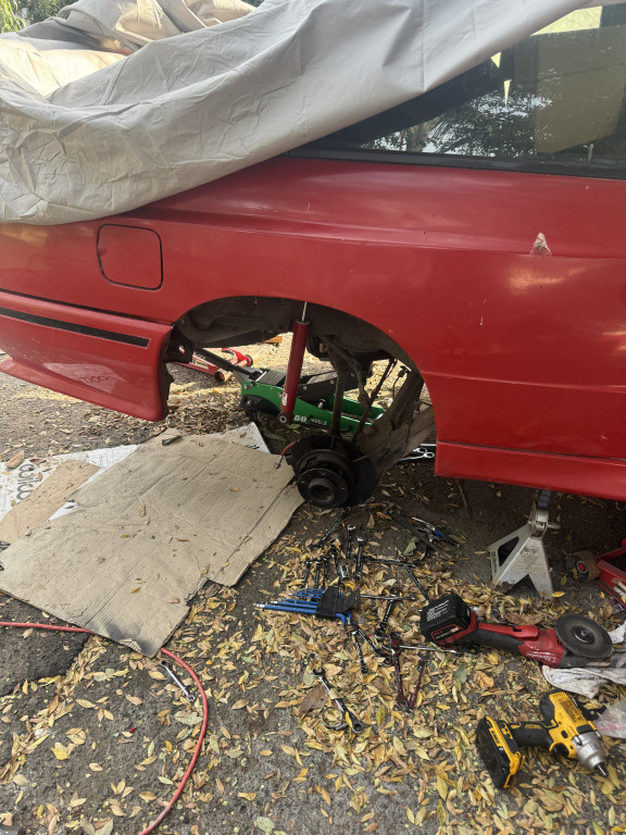

I worked on removing the rear end suspension. I disconnected everything. I had a hick up on drive shaft. I will need to remove it this week this week.

After posting diff I realized I had the bushings up side down.Last edited by e30m3s54turbo; 10-27-2024, 07:05 PM.Projects Hartge,Alpina & AC Schnitzer Builds.http://www.r3vlimited.com/board/showthread.php?t=280601

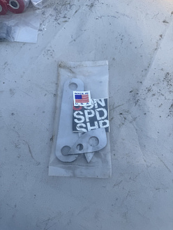

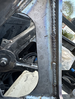

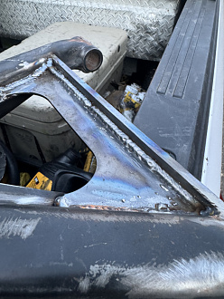

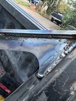

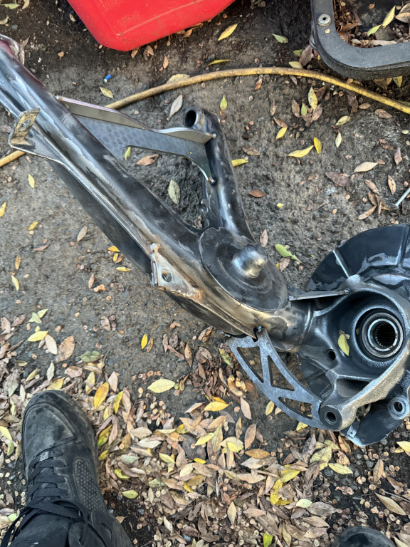

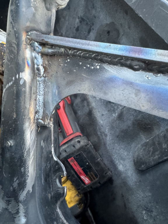

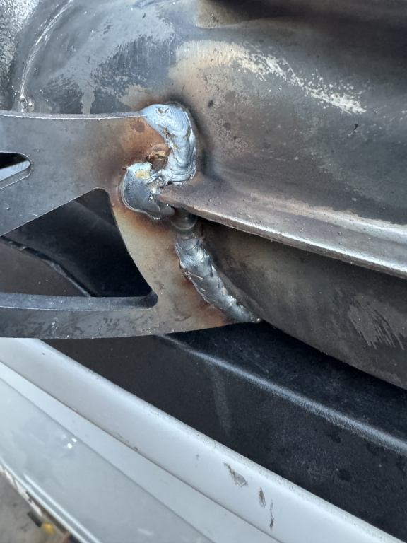

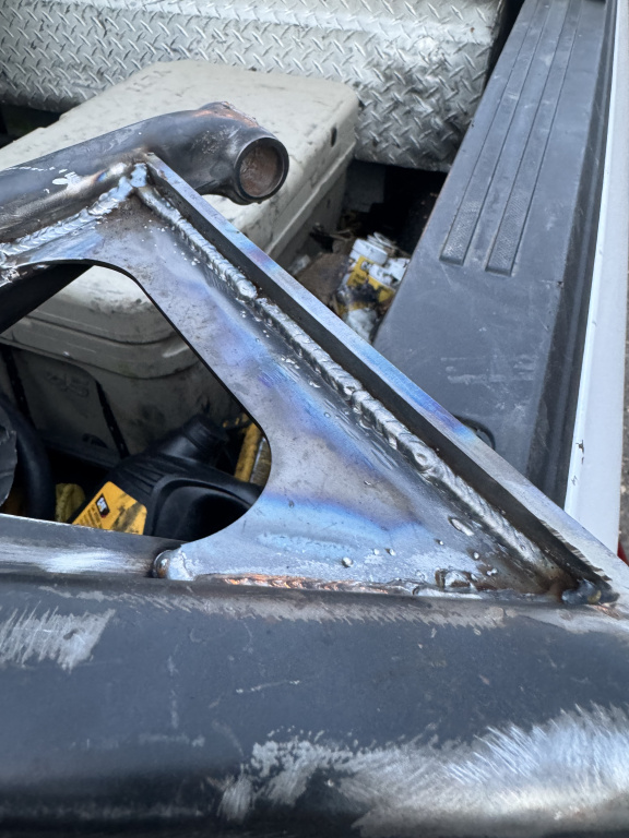

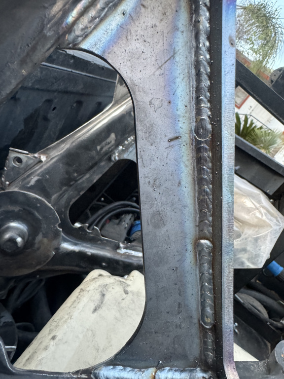

On Saturday and Sunday finally separated the the rear end apart. The bushes been on e30 for 37 years on. They were hard and cracked. I started to mock up camber plates to cut and weld on. I want to see how I need to modify. I decided to buy to buy new bearings and differential kit. I bought Condor diff metal plates to Weld on subframe. is it

nice work!! what did your buddy fix on the black car?Comment
We switched white relay with the red m car and Alpina project. The white relay was bad. The 20 year Nology plug wires were shooting sparks on side of tubes. Two injectors were sticking. I ordered three. On Monday I’m going to order the remainder three to install them at once. He noticed the intake m88/3 boots were leaking vacuum. I ordered new NKG plugs and burned off exist fuel off oxen, sencer. I will order a other set NGK spark plugs.
I didn’t drive it for at least 8 years.
When I drove in town I got thumbs up and my friends were happy to see it on the road. My friend Maro has two e30’s that he has not driven in years. He owns a 1987 325is and a 1985 325e. I’m trying to sort out black m car to give him a ride on some curvy roads to experience. He never been a modified e30. At this point he is stuck on mini Cooper’s.Last edited by e30m3s54turbo; 12-01-2024, 03:19 PM.Projects Hartge,Alpina & AC Schnitzer Builds.http://www.r3vlimited.com/board/showthread.php?t=280601

don't make sure the trailing arm reinforcements don't rub the fuel filler hose before powder coating them.Comment
