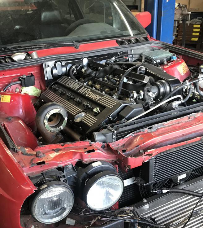

what is your cooling solution for s38 turbo in e30?318iS Track Rat :nice: www.drive4corners.com
Originally posted by downforce22 View Postwhat is your cooling solution for s38 turbo in e30?
l going to be using e28 M5 cooling system. That it includes e28 m5 radiator, thermostat housing, and radiator line. I will be using a 16” thin Spal push fan an two 10” pull fans on e28 M5 radiator.
I have the same set up on my other s38 m3 for 23 years with no problems.Projects Hartge,Alpina & AC Schnitzer Builds.http://www.r3vlimited.com/board/showthread.php?t=280601
DSC04926 by Raul Salinas, on Flickr
DSC03413 by Raul Salinas, on Flickr
mine wouldnt cool at idle/ heatsoak conditions with 535i e28 radiator/ 16" spal pusher and s38 themostat housing so I am installing a different core spaced forward and puller fan318iS Track Rat :nice: www.drive4corners.com

I’m moving the e30 to build my costume turbo. The PPF turbo manifold will not work in e30 engine bay.
