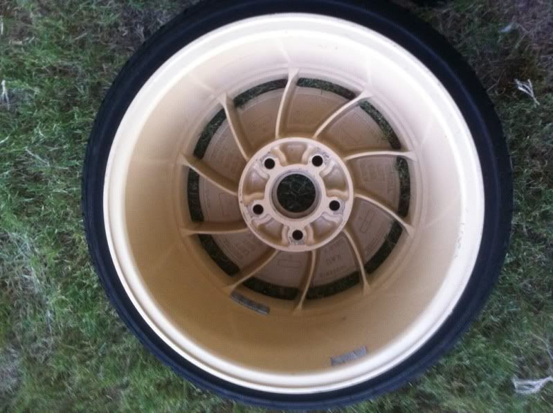

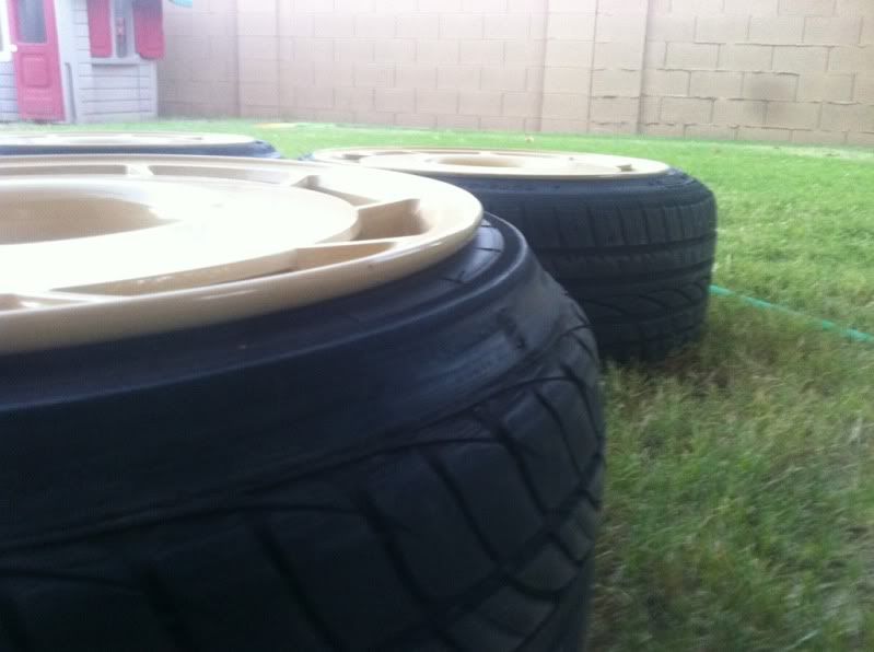

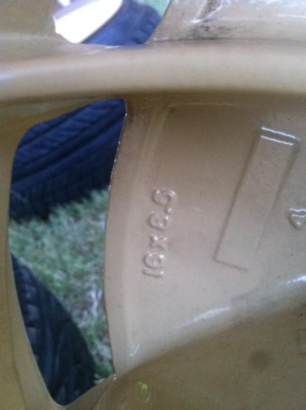

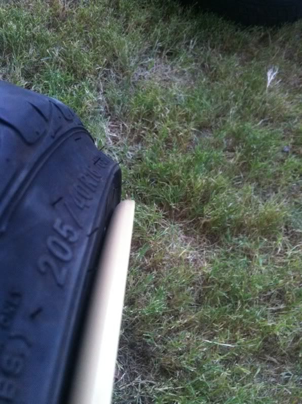

      not one rash spot!!!
      they are fully powder coated really nice.
      16x9.5
      16x8.5
      ALL with 205/40 rubber. its a little small but we will see how it looks

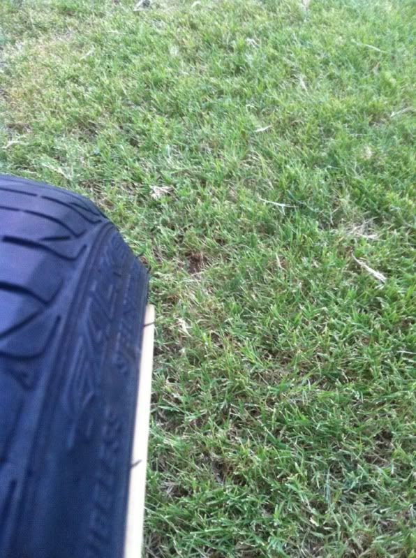

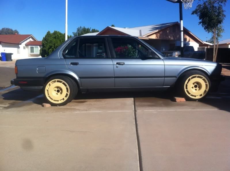

          Drove my e30 for the first time in a week boy I missed it!
          Gave it a wash. And took this pic.
          I need to sell the epsilons so I can get adapters and door cards!!!!

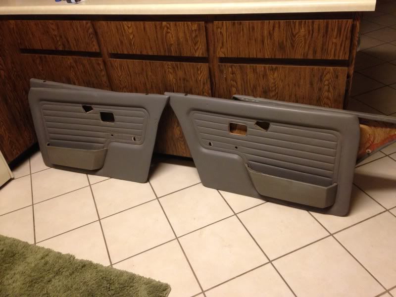

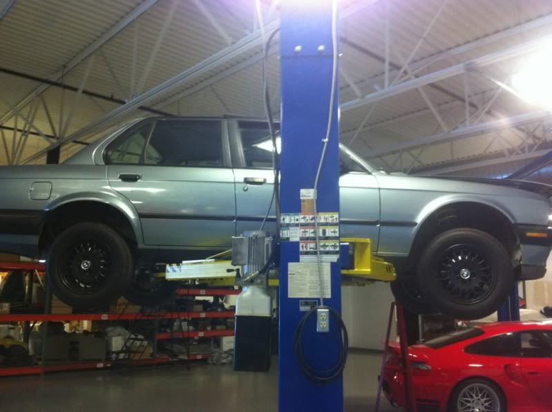

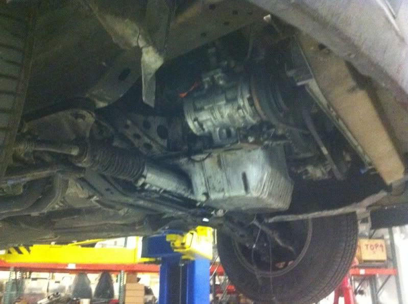

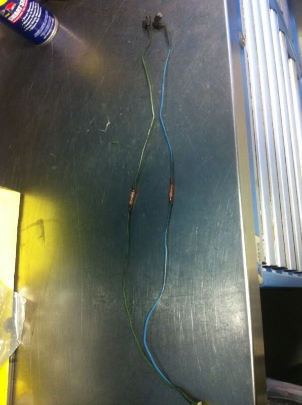

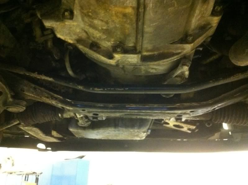

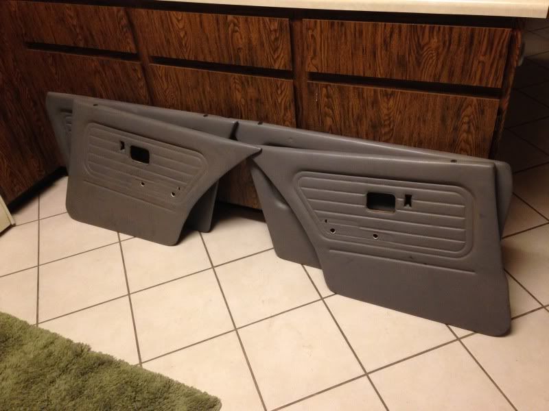

            I sold my extra expedition this weekend and picked up some SILBER door cards to go with my back seat. on Friday my temp and fuel gauges died and my tach started to acked all wacky. I thought it was the SI board crapping out on me so I made plans to pull it on sun and look at it( need to do the cluster repair still but need to order the gears. I first checked the #10 fuse and it was blown so I replaced it and everything worked again so I Googled "E30 #10 fuse blown" and read that the most likely cause is the revers lights wires off the trans are shorting out. So I put in the air with my helper and there was 2 ripped wires I pulled them off the car and did a repair. NO more problems.
            now the PICS>
            Helper
            LIFTED
            Wire repair

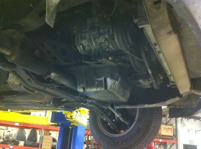

            Now on to cleaning. I really want to get the car to a very clean state. I hate motors caked with oil it bugs me to no end. so I will do a couple cleaning session to get it all off.. ROME WASN'T BUILD IN A DAY AND ALL THIS OIL WONT COME OFF IN ONE. is my cleaning moto.
            DIRTY
            Clean up

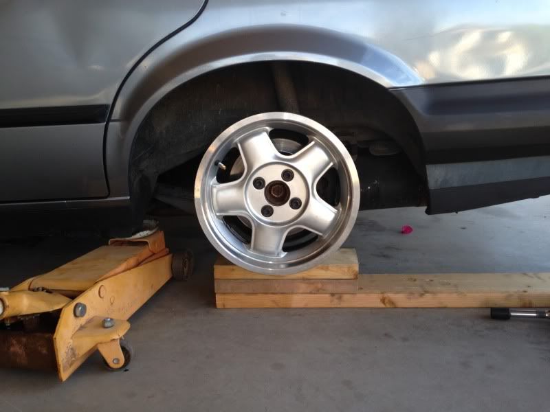

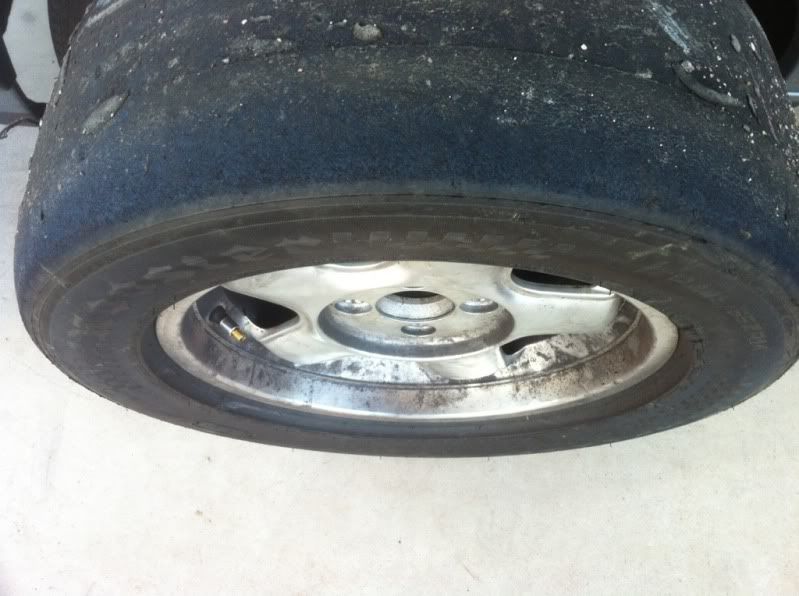

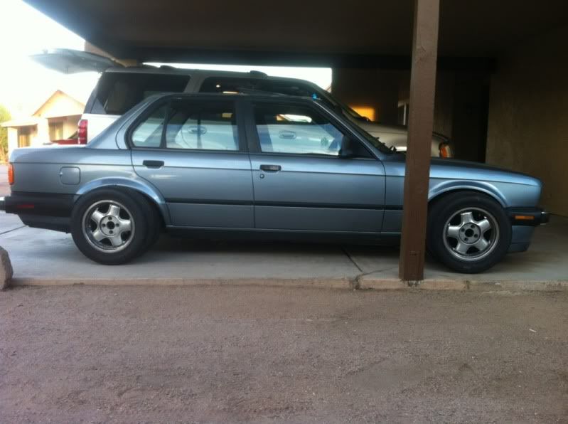

            After all this I picked up another set of wheels.. I know. at least these are 4x100.
            they look like old Revolutions rpx or schmindt moderlines they are 14x6.5 no marking on them at all and super light was told 8.5 each rim. came off a spec CRX.
            Wheels with HOOSERS rubber.
            Little Lip

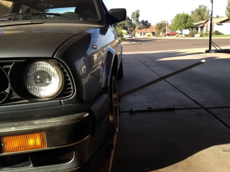

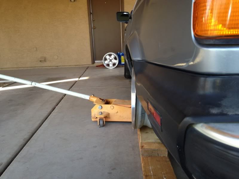

              test fit was good. I want the rear to sit more flush. so Im picking up spacers and stud kit.

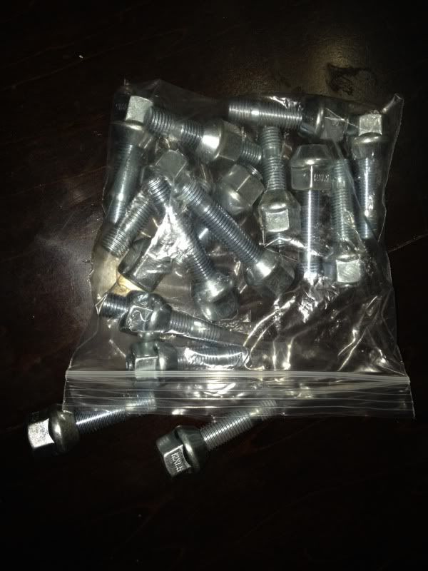

                      I "was " going to swap tire this week. But cash could persuade me keep up with my "other" wheels .
                      New studs and nuts for the wheels. Waiting on 10 mm spacers..

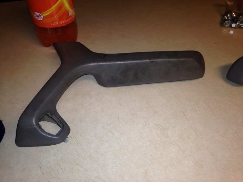

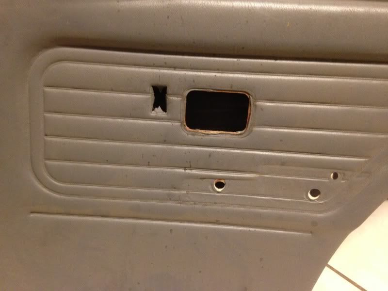

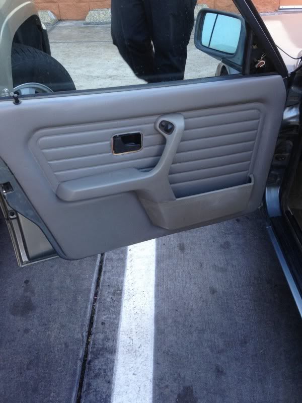

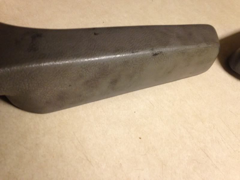

                          but I can Whore out my new interior bits..

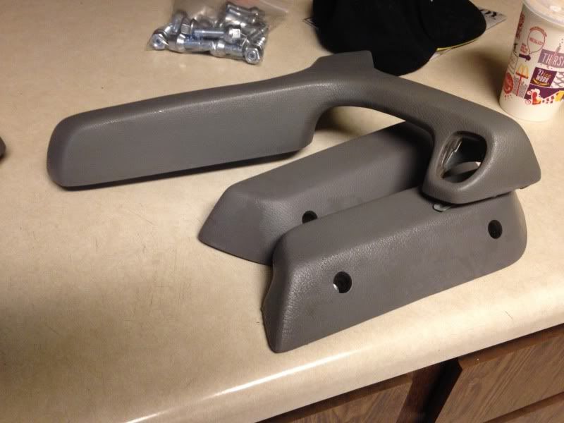

                          door cards get a good scrubbing tonight and then INSTALLATION!!!!!!

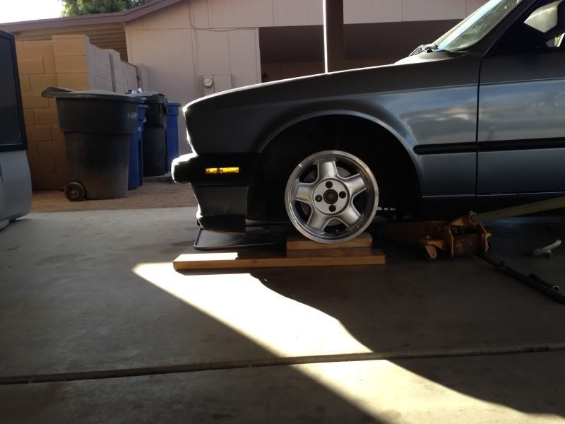

                              drity!!!!!!!!!!!!!!!!!!!
                              Cleaned and drivers side installed!!!!!
