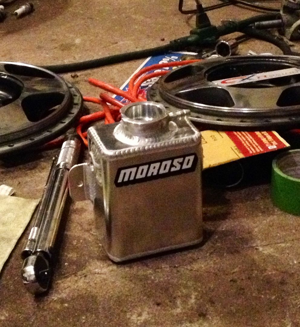

                          • Dirk HX35
                            • Jul 2013
                            • 346
                            Deleted the ABS today
                            And my overflow tank came
                            Bang Gears & Burn Rubber.
                            Instagram: @Dirk_LSXT
                            Buy my m20 racecar parts, help fund my lsx turbo swap.
