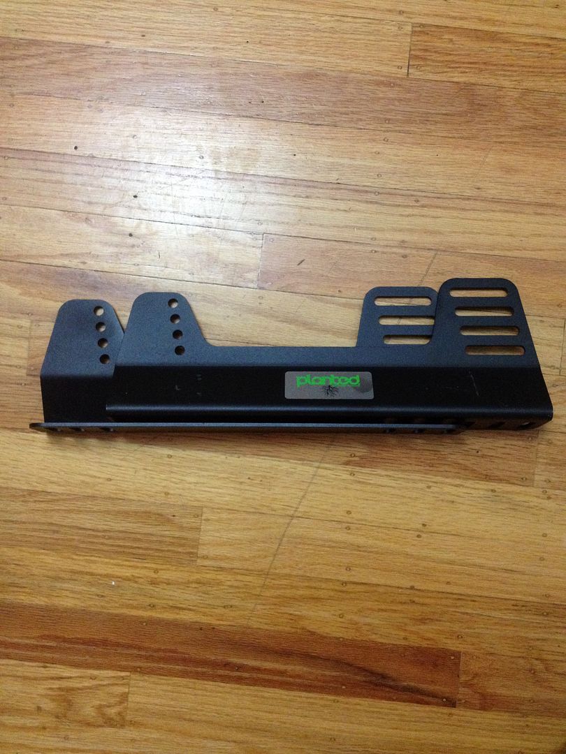

              Hey great news! Sadly its not a Dacia Sandero
              But I did get some sweet Planted side mounts for my MOMO seat

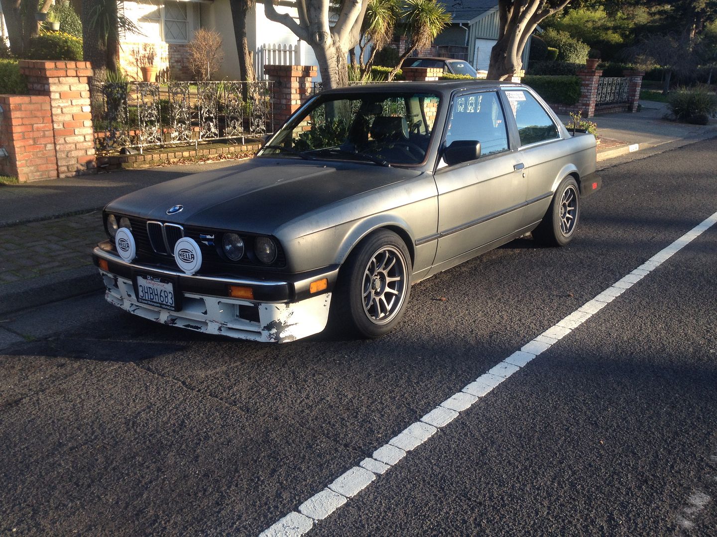

                    #84
                    Loving the Hellas

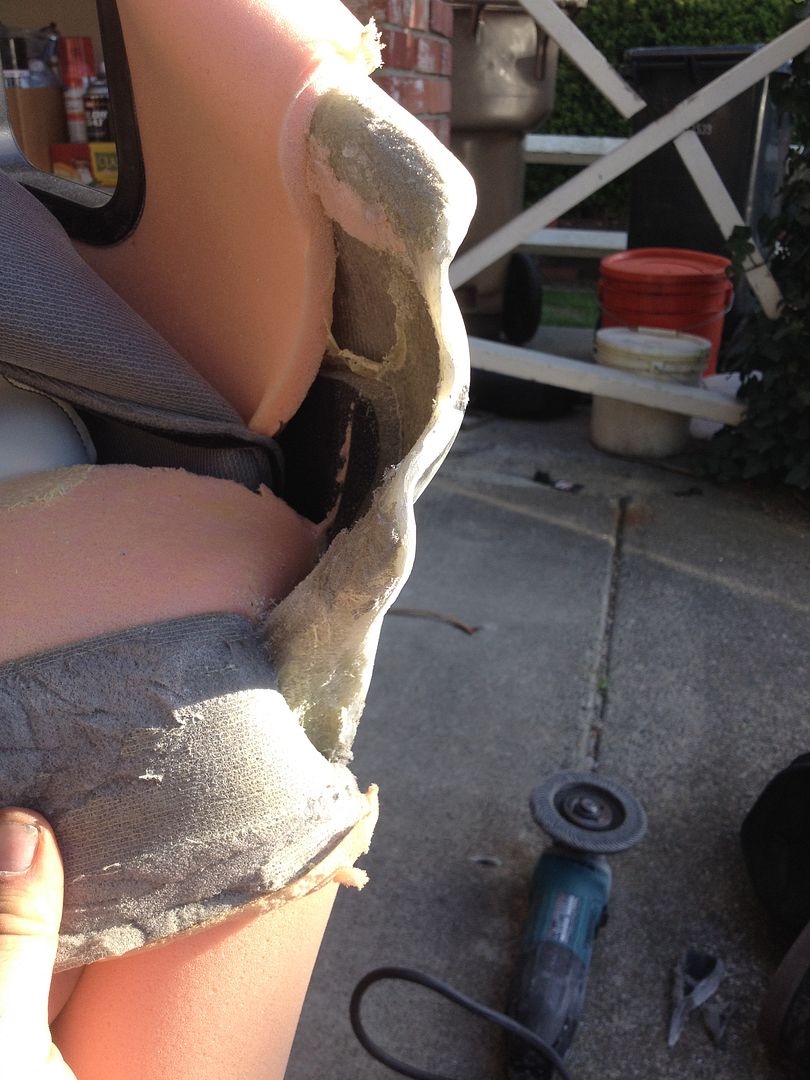

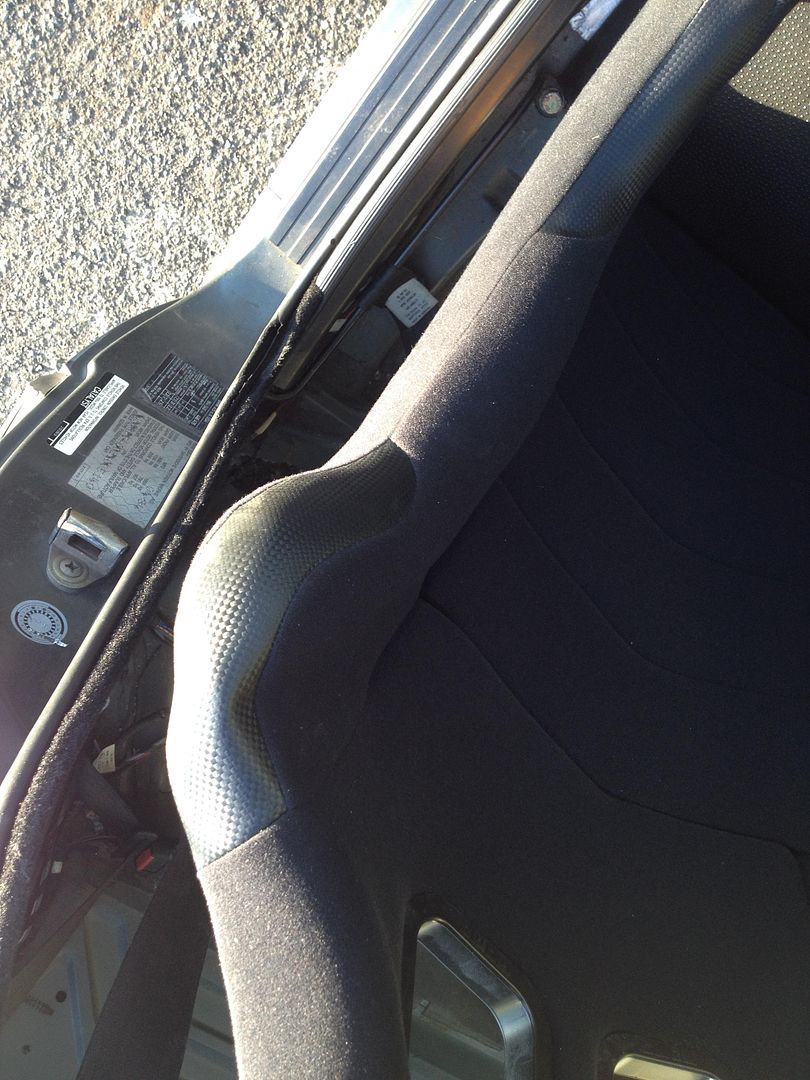

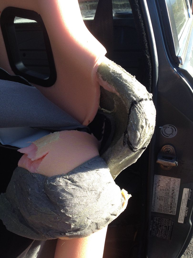

                        I got my MOMO seat today. I was not aware that fitting a racing seat in an e30 was this damn complicated! I did not know anything over 24" was basically not going to fit with out chopping shit up. I wont fit in anything 24" or smaller lol
                        Oh well.
                        So now I am trying to figure out how to make this shit fit. Also the seat showed up scratched and the cloth has some small holes at the tips of the bolsters from rubbing on the box during shipping or something. Pissed me off.
                        Iv got the seat right where I want it but its hitting the center consul, and wont let the door close.
                        My only option as I see it right now is to notch a section out of the door and relocate the door latchy thing a bit. WAFFLES!!!! :(
                        • deutschman
                          • May 2008
                          • 5958
                          #87

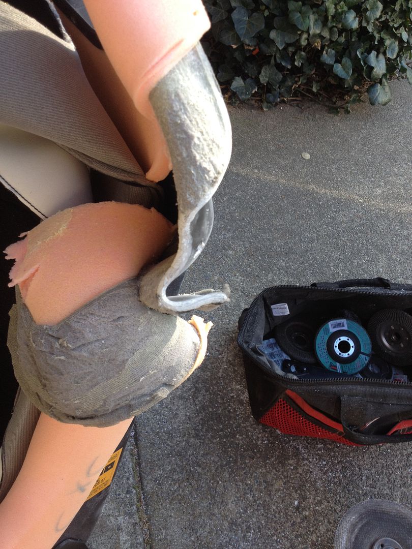

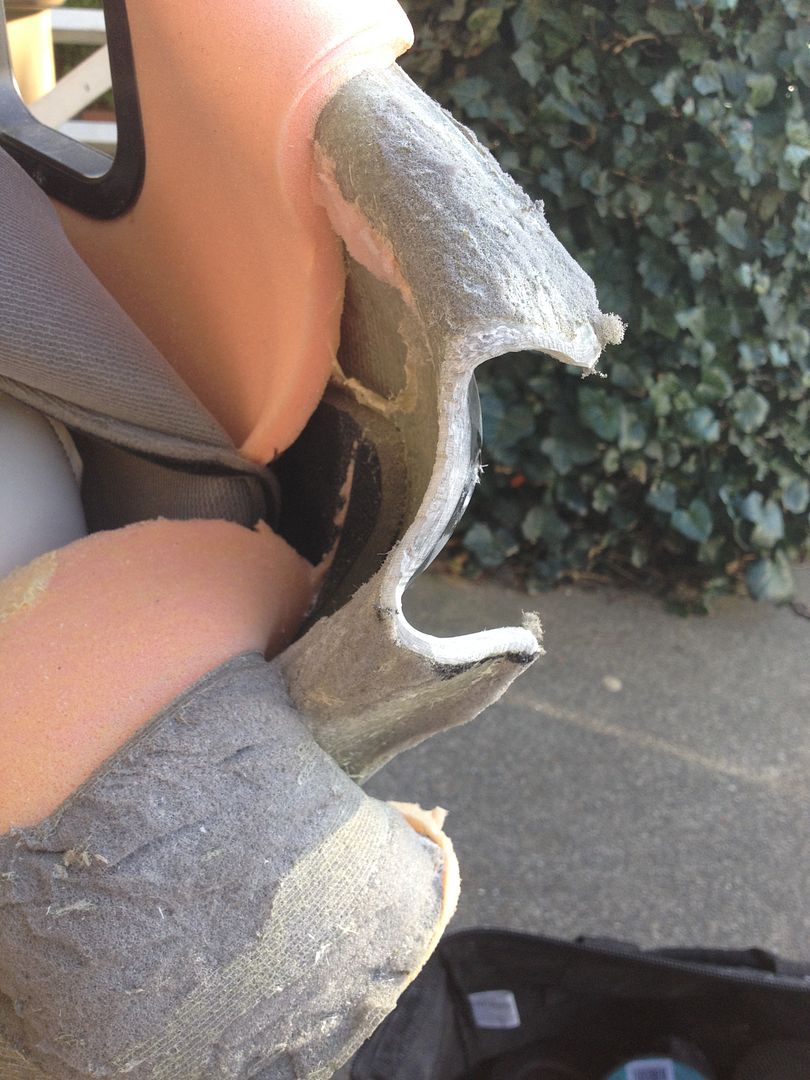

                          After talking to a few people, most of all Levent at Guten Parts, I finely decided how I would make my seat fit. I decides to cut some pieces off of the left shoulder bolster. It ended up being the best plan because its easier to cut fiber glass then metal, cutting into the door right where the little door knob sticks up would have sucked, and after the seat cover goes back on it is almost impossible to see the seat was notched around the door. I sat in the seat after cutting on it and it feels no different.
                          I think it was the very best thing to do, with the least amount of downsides.
                          I just cut a bit, fitted the seat, cut a bit more, and so on until it fit correctly. I glued the foam back on, and wrapped the cover back around it. Easy.
                          Progression.
                          The seat cover is a bit loos in the corner but its not bad.
                          I still need to get some hardware to get the brackets mounted to the floor. Thats about it.

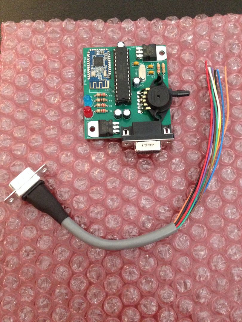

                              I got my Chariot Gauge electronics today :)
