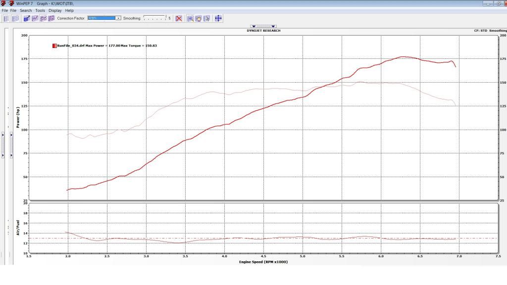

    200k mile bone stock m50b25...

      ^Bone Stock as in a baseline run or after the ITB's ? I am not familiar with what a stock one of those puts down.
      Dynorun 34 leads me to believe post ITB install. Nice afr curve...

        needs a baseline.......IMO should have done test on a healthy B28.

          Please overlay that curve with the baseline, and a description of what all is different between them.
          If it's just the ITB conversion then a before/after dyno would be extremely interesting to see! If you added headers and other crap, not so much.
            Agreed, but I traded my wife's minivan with a slipping transmission for the e36 and used it to get everything working properly. This has all been done on the very few spare pennies I have from my own pocket.
            There's a few locals whom I wrote dyno'd chips for, probably going to use one of them for a before/after, none of which are b25's. We both know the 45mm is a tad large for a stock b25, but seeing this much power from a tired one is promising. Now that everything is working properly and I have a grasp of the Alpha-N OBD1, can't wait to put them on a larger/healthier motor. Might not even bother with putting the stock manifold/car on the dyno and wasting the time, effort and money.

              A "PRO3" race motor is lucky to get 155 on the ground. Thats whatever tune, whatever exhaust, no internal or intake mods at all.
              177 is a fucking miracle on a bone stock B25.
                lol we are talking M50b25 right? 155rwhp from a fresh M50b25 is BS they are 190ish crank from BMW.
                a fresh M20B25 with careful attention is 150-155whp.
                also dont focus on peak numbers

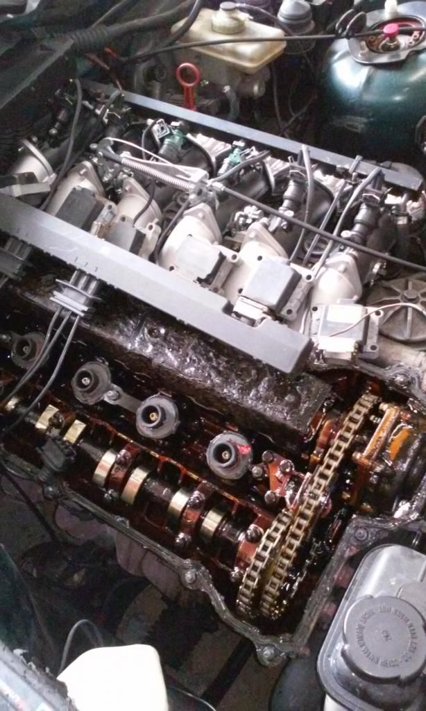

                • ForcedFirebird
                  • Feb 2007
                  • 8300
                  #143
                  Bone stock m50b25, OBD1 exhaust manifolds, stock cams (verified in pic below). No baseline, this was a spur of the moment trade for the e36 shortly after the first manifold adapter was prototyped. 200k mile motor in bad shape. Will get some numbers on healthy/larger motors soon.
                  The odo shows just under 201,000, and appears to have had a very hard life.
                    yeah a worn out M50B25 is just not going to do it justice thats all.
                      The dyno says otherwise, well the one I have been using. Healthy stripped down race trim, single resonator motors make 145-155whp. That's a spec e30 built to the rules of .020" over, crank baffles/scrapers and balancing only. In fact they are DQ over 168whp (IIRC).
                        Still made 177whp lol. I searched and searched posted dynographs. Seems a cammed, healthy m50b25 is about the same as these ITB's.
                          yeah peak gains will be there on a free flowing head but overlay the curves....
                          what airbox/filter you using?
                              Open trumpets today.

                                My old 300k+ 100% stock M50TU made 175hp and 160tq on a dynojet.
