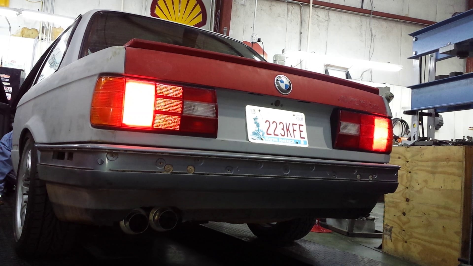

        Haven't had much time to spend on the car but I've made small progress here and there. The euro smiley headlights are wired in, finally:
        The exhaust is getting close to done. Still need to secure the rear mufflers (they are held up with tig wire at the moment) as well as weld the v-band clamps at the mid muffler - but it is getting close!
        ...and a little exhaust video.
        [vimeo=500,281]109540286[/vimeo]

              FYI, this is with my custom headers down to 3" collectors. From there it drops to 2.5" to a Borla Turbo XL 400286 muffler. This muffler has an integral x-pipe. Continued the dual 2.5" to the back where there are 2 Magnaflow 10416 mufflers welded together.
              Not sure if I am going to extend tips out or not, I kind of like it as is.
