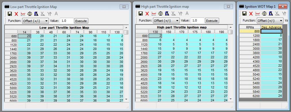

      Unless you made a chip for Motronic, that's probably why you are getting knock. Your profile shows you are in the USA, but we don't use RON rating, we use octane. I have a feeling using e100 won't help you much, either (until you get VEMS installed), as you will need to add a lot more fuel vs conventional gasoline (again, you would need a chip for that).
      How much is your cranking compression? Anything much over 235psi and gasoline will self ignite (using 93 octane, not sure how that translates to RON). Before changing pistons, might want to go with more cam duration (Schrick makes a 304°) to bring your trapped mass down int he lower RPM.
      Here is the stock timing table:
Name:	Stock 173 timing maps.jpg
      As you can see, the reason your knock is probably going away is BMW pulled almost 10° timing at mean torque (~3600-5000rpm) in the higher load areas. If you lowered the timing advance before 3600, you would have less issues, might even be able to get away with pump gas.

        Hi Jon,thank you for a help,no chip just oem 173 ecu as I stated that is just test,I do work in USA I dont live,98ron is 91oct in USA,let see can it get any close to 240whp with my setup.I need to wait for vems.

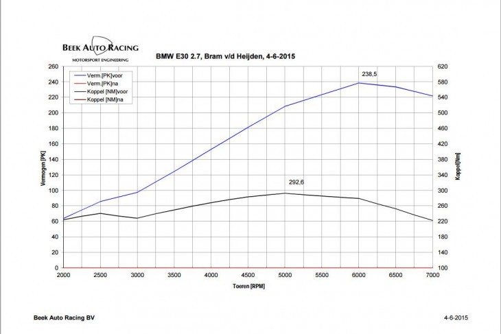

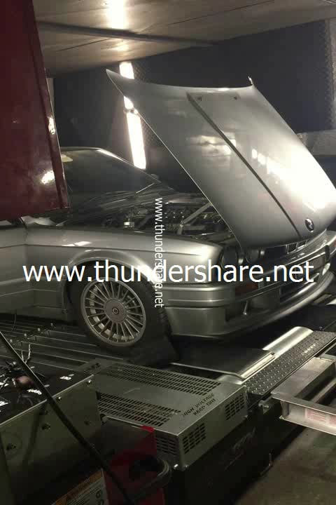

                      Guess you are wrong about the stock manifold not being able to produce proper power. This is my 2.7 output with the 'stock' (it's matched to the head) manifold:
                        You have to compare apples to apples. Is that a real wheel power number, or that weird calculation of brake power calculated from wheel power?
                          Click image for larger version  Name:	E30_3.jpg Views:	0 Size:	54.5 KB ID:	9919317
                          Click image for larger version  Name:	20170406_094557.jpg Views:	0 Size:	87.0 KB ID:	9919316
                          stock manifold is good for around 220-230 whp +/- which is around 250-260 bhp+/- so yeah 235 SAE hp at flywheel is achievable.
                          years ago a guy build a 2.7 whith good CR stock manifold and huge dbilas cam 312 degrees or something crazy and it still fell with this ball park.
                          It does come down to your definition of proper power
                            Interesting to call the standard measurement process of German Bosch dyno as "weird".
                              Yes. Weird. In Europe a lot of chassis dynos will measure WHEEL power, then reverse calculate BRAKE power. Now why wouldn't it be either use brake power measured at the crankshaft and wheel power measured at the wheels? Reverse calculating drive train loss? Just state the wheel numbers and be done with it. The post with that last dyno graph didn't give much info on how those numbers were obtained.

                                #375
                                You usually want to measure the engine power, and be less interested about your drivetrain losses etc. By measuring the wheel power you can guesstimate the live performance of the car, no problem in that.
                                Readings of dynos are always under debate. And always dynos of others read higher.
