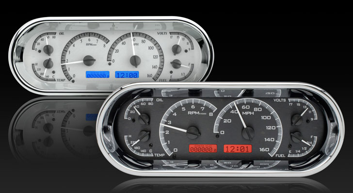

                THoughts on these choices?
                1. Stewart Warner "wings"?
                2. Then there's this... I'm starting to like this a lot...
                1 is more classic and stuff. A pain BC I can't fit them all in the spot for them in the dash, so several end up somewhere else...:(
                2 is more modern and looks awesome. A clean package and install, they all fit behind the steering wheel where they should... I think I'm leaning this way now.
                I've been sort of on the fence for a while now on what to do for gauges. The time is nigh for a decision. I WANT TO BE DONE SOON!

                  Definitely 2. If those have all the information you need then a whole cluster makes packaging super easy.

                  • DER E30
                    • Sep 2013
                    • 2349
                    I kinda forgot about taking pics, so this is the beginning. You didn't miss much, I spent probably an hour thinking about making this cut and welds
                    I cut out the entire stock gauge mounting area as one piece. That seemed the most logical and straightforward solution.
                    What am I cutting the dash for? This Dakota Digital VHX, the cluster wil glow orange/red with white needles at night.
                    View from the driver's seat. The protective plastic is still on the gauges, that's why they look weird.
