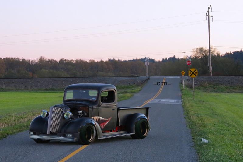

                    Sweet build ! I got bored so I decided to photoshop your truck .

                      That's pretty neat! Haha
