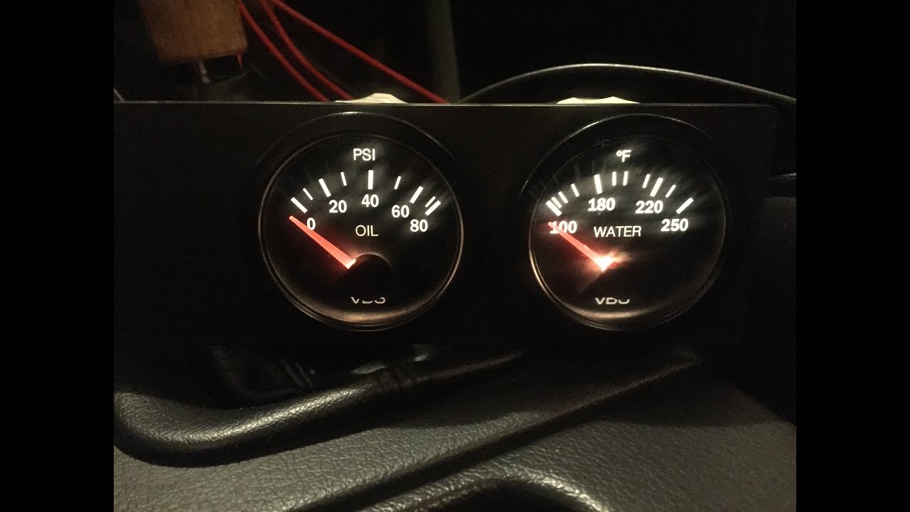

    Glovebox Hidden/Stealth Radio
    I had previously (quickly) installed a headless radio setup, complete with terrible wiring job. I then jammed the components behind the dash. This left me with only a power switch and 3.5mm input beside my single VDO gauge.
    I've since decided the audio quality of this setup is good enough until the car is "finished" and I install an audiophile worthy stereo, so I wanted to make the whole thing a little prettier.
    I was getting kind of tired looking at my cracked and taped together radio panel (complete with VDO gauge constantly falling out). I relocated my audio system to the glovebox and rewired everything properly this time (Would have looked nicer if I used 20ga wiring instead of the 16ga I had on hand).
    Unfortunately I used my VDO oil pressure sender in my jeep a few years back, so I need to purchase a new one for the E30 to make the gauge functional.
    While I was in there, I also ran all the wiring for my VDO oil temperature gauge. I seem to have misplaced my ashtray delete panel, so I didn't actually get to installing that gauge.

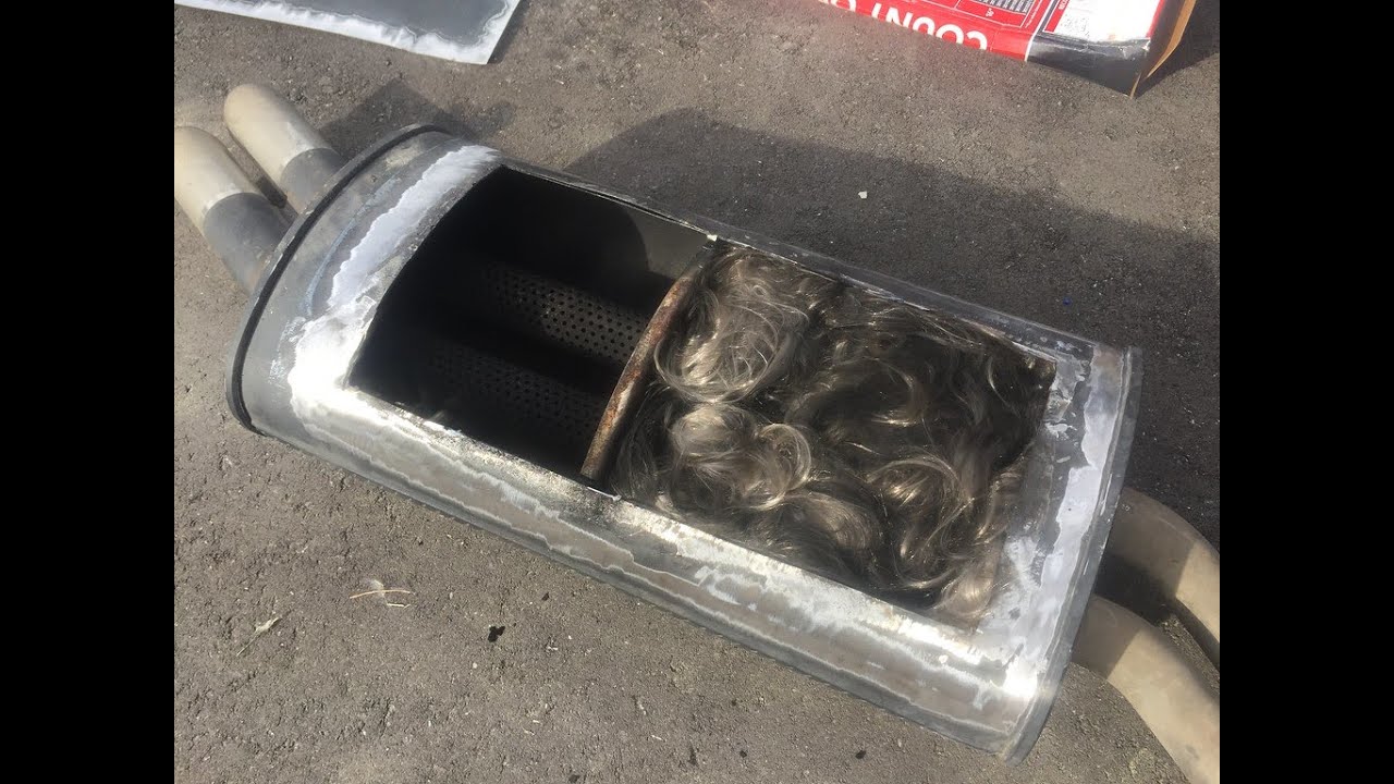

        Custom Exhaust Repack
        June 15th, 2018
        Unhappy with the quiet state of my ANSA Sport cat back exhaust system, I decided to take matters into my own hands.
        I wanted something a little throatier, without sacrificing highway driveability.
        As a test, I cut open the muffler, removed half the packing, tack welded the old metal in place, and gorilla taped the seams.
        After driving around for a while, I was mostly happy with the sound but wanted to remove a little rasp/drone.
        I added some additional packing (from the other side), and fully welded up the muffler (using sheet metal from my old 325e parts car roof no less!)
        I'm pleased with the final sound, and it was free!
