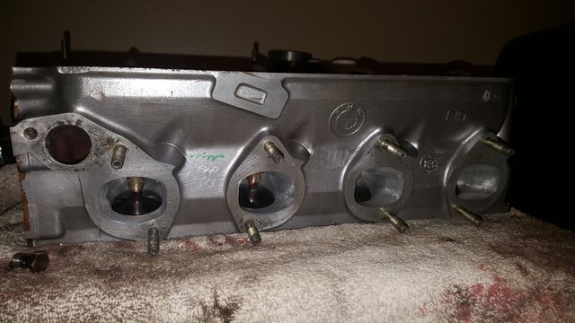

    Finished porting and gasket matching, lapped the valves, popped on the valve seals, added some h/d springs with crower chromoly retainers and some rocker locks and all new hardware, adjusted lash to .08 and the head is all ready to go.

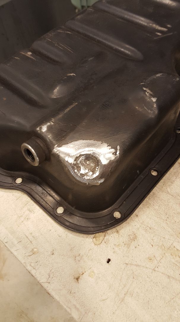

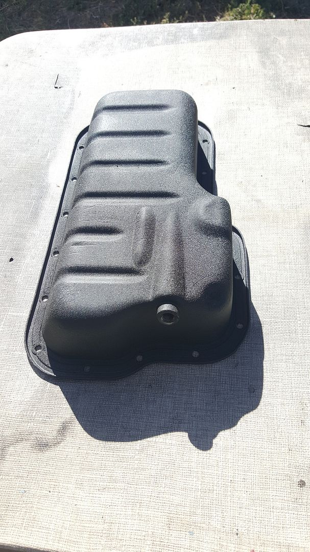

      Welded up the hole punched im the pan by the junkyard and hit it with some black wrinkle coat.

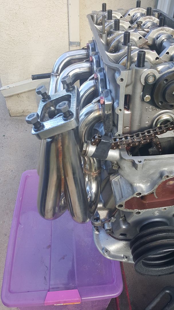

              Turbo manifold came in today. Looks great, fits great, no fittment issues yet

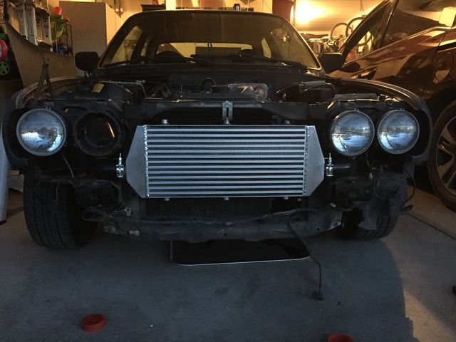

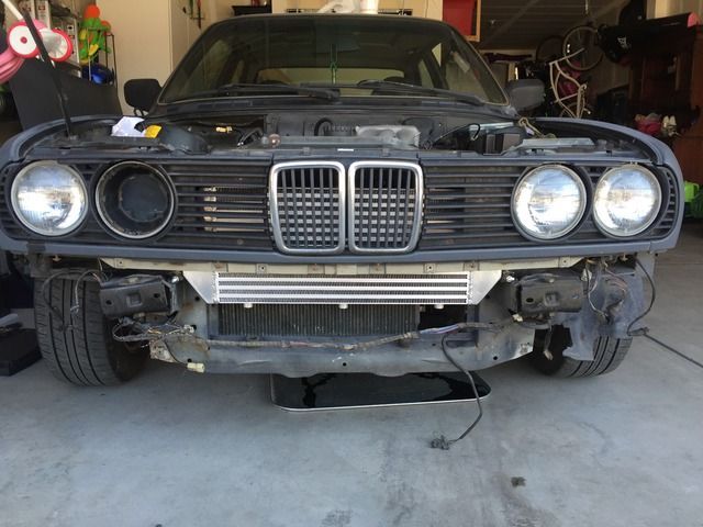

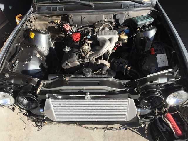

                      Got the 21x9x2.75 Intercooler fit, and it fits beautifully.
                      Had to do a little cutting, trimming and hammering under the hood to get a few things smoothed out and cleaned up.
                      Started fitting the Intercooler piping
                      Blow off valve mounted
                      A little bit of paint and polishing and shes starting to look mighty pretty!

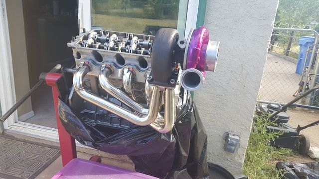

                        Test fit the holset under the hood and it fits perfectly, no clearance issues what so ever, it it extremly tight but everything clears besides the thermostat/radiator hoses against the manifold.

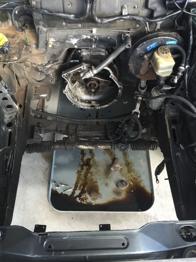

                                Got the old worn out m10 pulled and set off to the side, power washed
                                She was a dirty old girl. But cleaned up pretty nicely
                                installed new throw out bearing, revshift 95a poly motor mounts, 95a poly trans mounts and power steering delete block.
                                Dropped the trans to install some new delrin bushings, but I got the wrong set so I am needing to order the right stuff and since it is all out and pulled apart, I am thinking of going the solid mount route like this one below and doing the z3 shifter and fabbing up a dssr out of some scrap I have laying around. Might as well get it all out of the way while it's all out, right?
