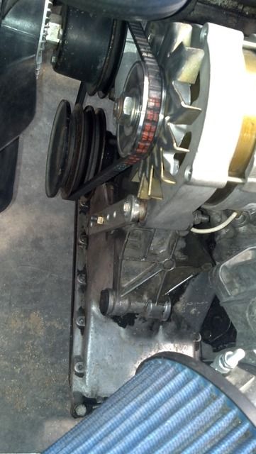

    Drilled aluminum alternator/ps pump brackets cut down and installed. Just need a little polishing

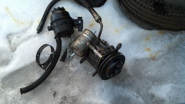

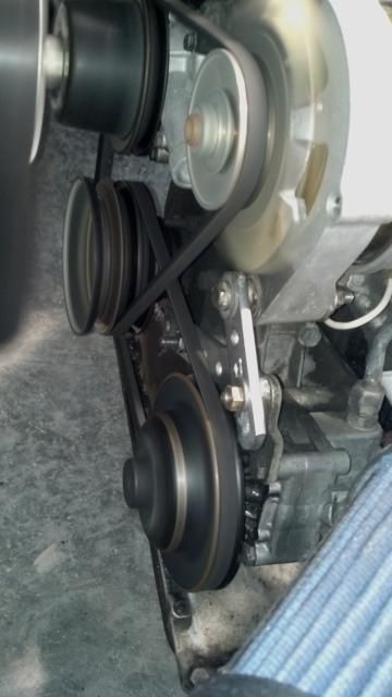

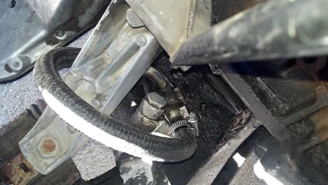

          Deleted the power steering last week. Pump was going out so i decided to pull the belt and see how it was, liked the way it felt so i decided to pull it all off.
          Just made a loop at the r&p end with one of the old hoses.
          Love the way it feels. Steering is much tighter. It it pretty touchy at high speeds though. Thinking an alignment may help that a little.

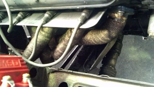

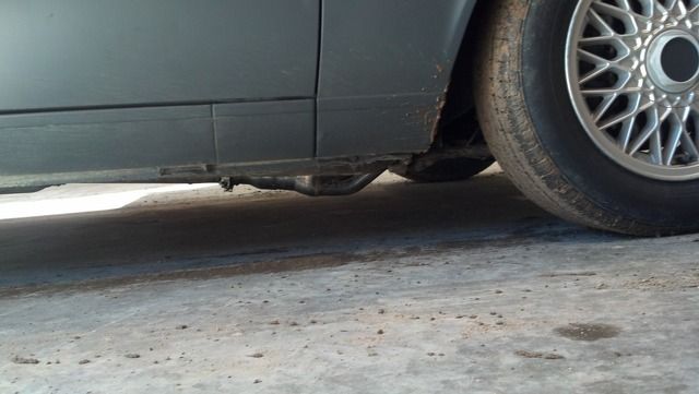

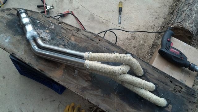

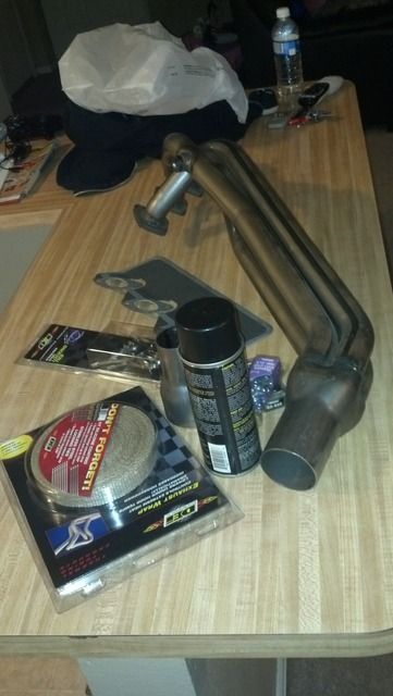

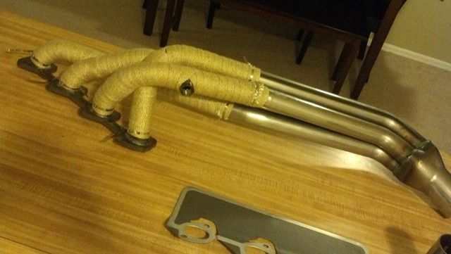

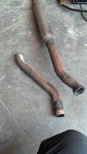

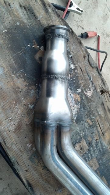

            Exhaust revised : Orderd a racetep header and picked up some other goodies.
            Wrapped the header primaries
            Welded on a v-band collector
            Had to re route the piping to get the collector to mate up
            Welded in a new flex pipe
            Cut the back muffler off, leaving just the glasspack.
            Car is loud as all hell now! Obnoxiously loud lol But it sounds pretty mean. Well be looking into a new muffler to tone it down a little bit. Not sure what yet though

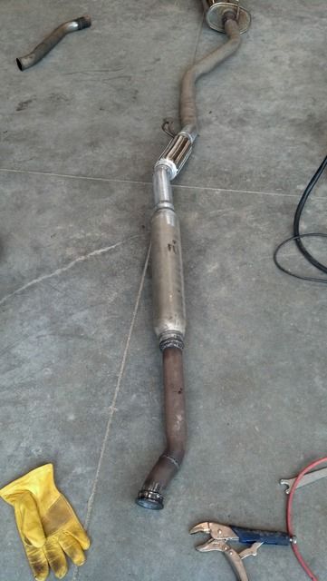

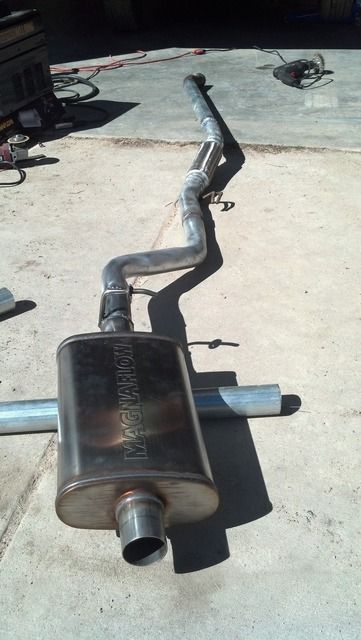

              #51

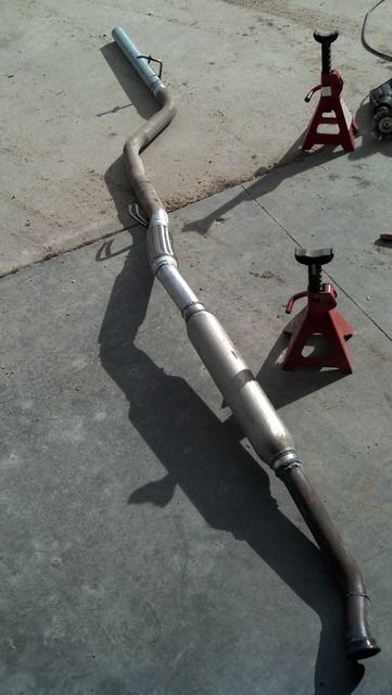

              Going to be re doing the exhaust again today. It's waayy to loud for street driving. So i went and picked upa magnaflow 11215 to weld back on. Will be cutting the glasspack out of the system as well.

              • 2mAn
                Señior Mod
                • 21079
                #52
                I'd leave the Glasspack in and still add the muffler. That's almost the exact setup i had on my old E30 and i loved it

                    I like the way the magnaflow sounds. I just cant get rid of the pesky high rpm buzz. Im thinking eventually adding a small resonator. But for now im satisfied with it.
                    318i exhaust v3:

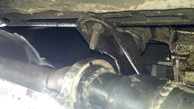

                      Had to add a small notch to the trans crossmember.

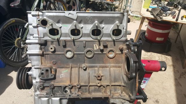

                        Been some time since ive updated this. Currently working on a rebuilding a junkyard m10 1.8. Hopefully will be boosting it as well. Cleaned it up, pulled the head and pan off and it all the internals look great.
                        Little bit of carbon build up on the exhaust valves but thats about it. Should make for a smooth rebuild

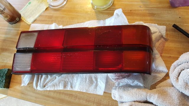

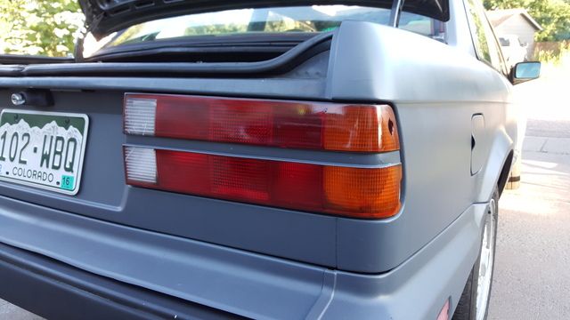

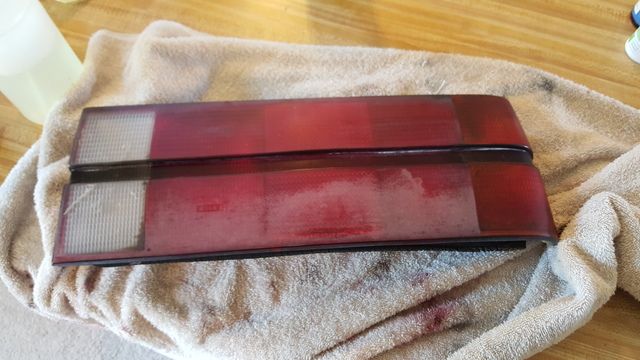

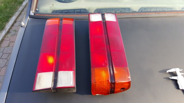

                          Did a little bit of taillight resto on the faded lenses a couple days ago.
                          Wet sanded them and then laid down some clear coat.
                          Not perfect but they look much better until i decide to buy new lenses

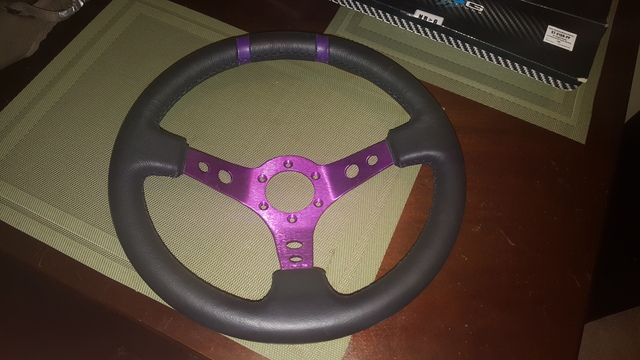

                            Picked up an nrg steering wheel for cheap. Just needing to order a hub adapter to bolt it on.

                              All cleaned up. Waiting on parts for reassembly.
                              Did some light port work to the 1.8i head. Hd springs and retainers will be here soon. Still needing to order a cam. Unsure if i want to go with a 284° shrick or a 284° regrind thought.
