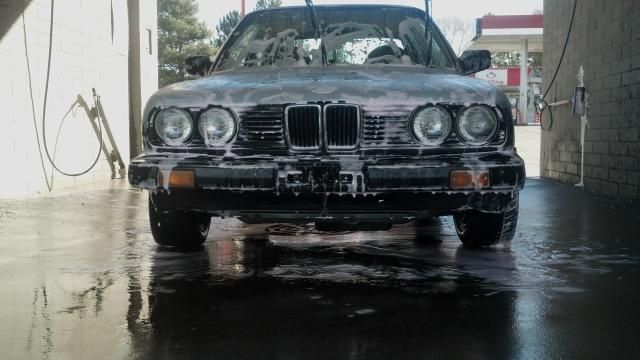

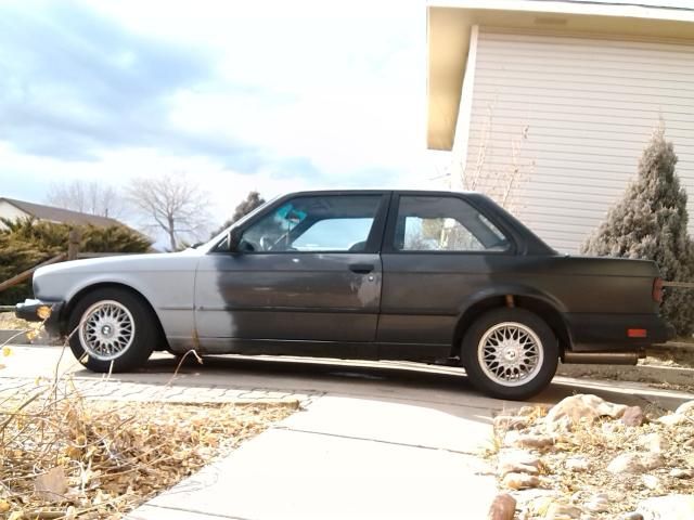

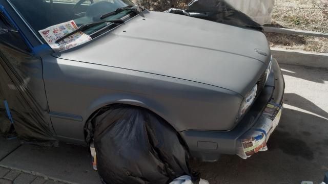

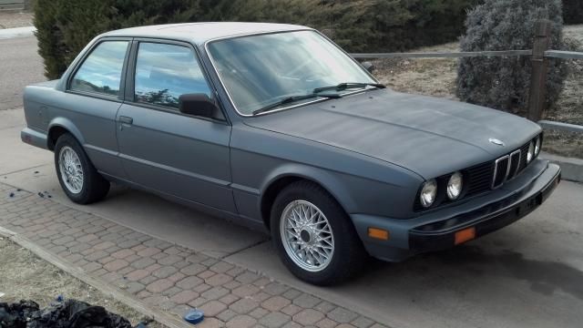

        Been a while since ive posted any updates. Did a few things to the old e30 this past week.
        Decided to try out plastidip for the first time. Came out pretty well! Sprayed it in gunmetal grey and the car looks GOOD!
        Still needing to finish the roof and trunk lid and re spray the hood. But it turned out nice

          #34
          Not bad looking! what happened to the old pics?

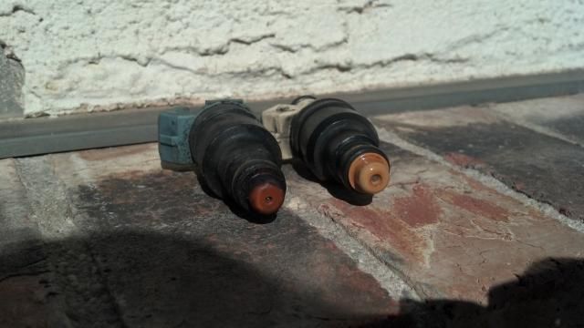

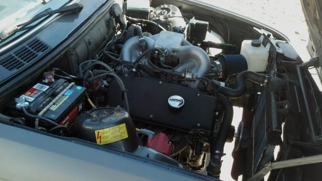

            #35

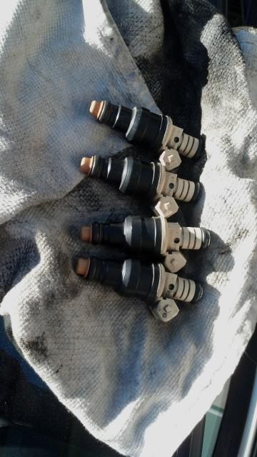

            Also picked up some higher flowing injectors from the local pick and pull off of a 2.0l vw jetta. They nade a big difference in driveability. Engine runs alot smoother and quieter while going down the road. after re-adjusting the afm and timing the car redlines around 6700rpm(unless my tach is off) and throttle response is much better as well. Quick, cheap, easy mod for the old m10!
            Stock injectors were pretty well worn!

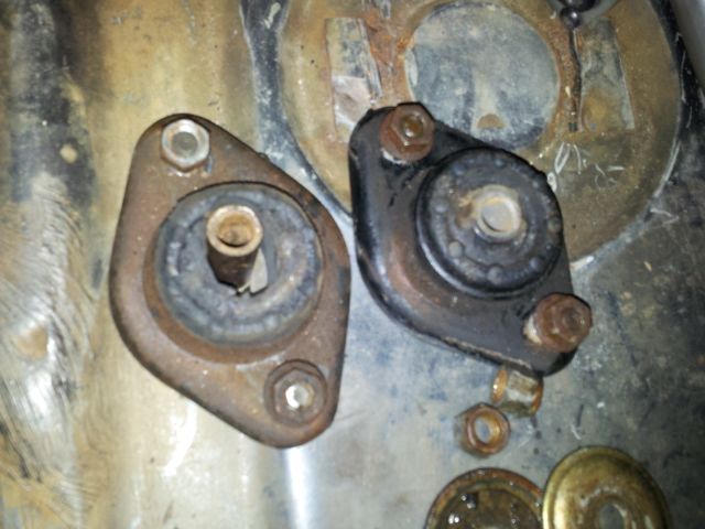

                #37

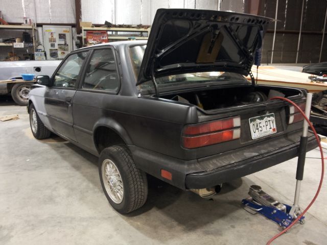

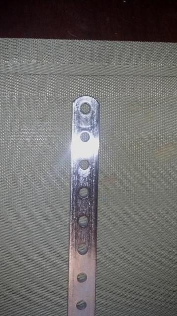

                Also in the last month. Rear shock mounts, water pump and trans mounts were replaced
                Had to make an alternator bracket out of some steel laying around the shoo because the original piece split
                A new better looking drilled aluminum piece is is the making to replace it

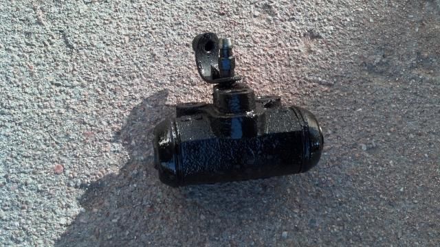

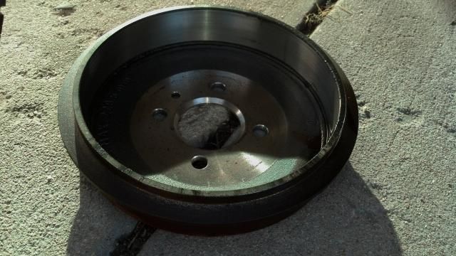

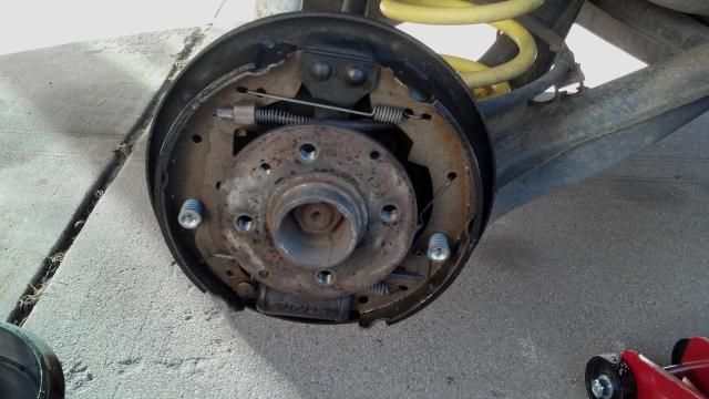

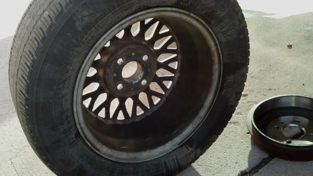

                        #41
                        Went out this morning to pull off the rear spring pads to get it a little lower in the rear. Jumped under the car and noticed break fluid leaking from the pass side rear drum.
                        The culprit..looks like everything was replaced by the po but this
                        glad i decided to get down there and look! Could of been going down the road and lost the breaks.

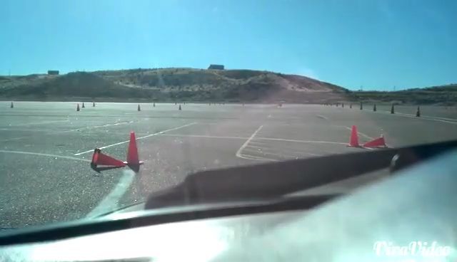

                              #44
                              First time out on the autox course at pikes peak international raceway. Had fun, even though i only got one lap in
                              Click link for video
