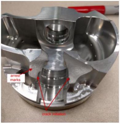

          I have an update on the car.
          Long story short, JE's 'analysis' claimed the piston installation caused the problem. Why that would take 3000 miles and a turbo to manifest, I have no idea. I didn't think they would do anything for me, especially considering I already bought the replacement.

            Can you cut and paste word for word what the manufacturer is claiming was the cause ?
            i can only think the notch for the circlip was gouged badly during install
            • downforce22
              • Aug 2009
              • 3193
              #141

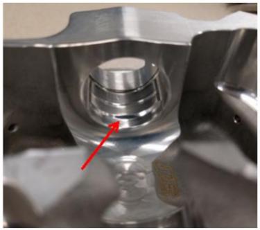

              Component Failure Investigation
              Background:
              Customer states slipper breakage on one side of the pin tower. We received 1 piston, 1 pin, and 2 circlips. Customer explained that he found the failure after hearing RPM dependent ticking noise and he continued running it until he found the source of the noise.
              Measurements:
              All dimensions related to the lock grooves were measured as well as the locks themselves and the pin. All components were in-spec except for the lock on the failed side of the pin tower. Details of the inspection dimensions can be found attached to the request form.
              Observations:
              Examining the fractured surface under slight magnification shows fatigue arrest marks that indicate a crack that initiated around the area of the pick lock groove. There also seems to be an initiation point on the other side of the pick lock groove around the wire lock groove area.
              We also observed a deep groove on the opposite pin tower that indicated that the pin ran significantly shifted over in the pin bore towards the side of the failure. The arrow in the picture
              Conclusion:
              It is my opinion that the order of events is as follows. First, the lock was ejected from the piston causing the pin to slide over in the pin bore. The pin was halted by the rail spacer and the engine continued to operate. Because the pin was only very slightly engaged on one side of the pin bore, the large amount of stress caused compressive plastic deformation in the pin bore. With every engine cycle, the pin became crooked in the pin bore and caused a large amount of stress on the very outside of the failed pin tower area where a crack was initiated at the highest stressed area (the pick lock groove). The pin tower eventually failed as seen in the received sample.
              The ejection of the lock was likely caused by improper installation because there were no obvious defects seen in the manufacturing process or in the design. The customer should refer to the instructions in our installation tips document provided with all pistons for a guide on how to install the wire locks (document is in this report packet).
              • digger
                • Nov 2005
                • 6199
                #142
                Was the lock in the groove when piston was removed? It probably would have fallen out in any case.
                You might be able to argue that the chunk falling out caused the lock to be ejected ?
