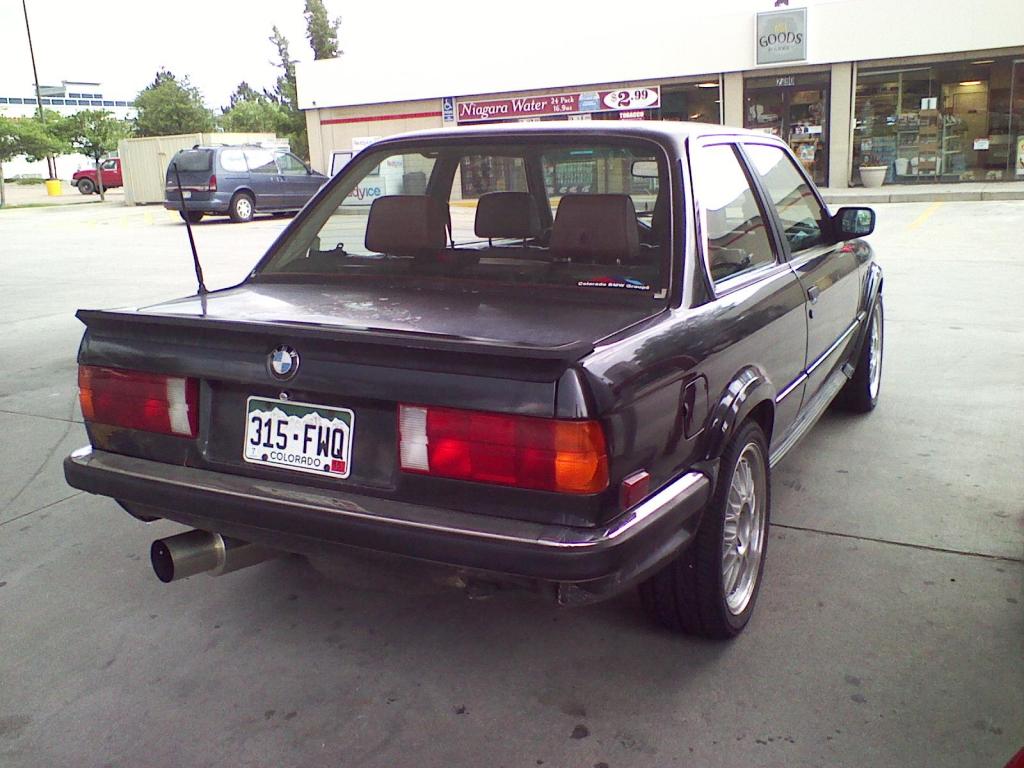

                The car is good enough for rally cross tomorrow so we shall see how it does. Here is a picture at the gas station with the e28 spoiler mounted. I couldn't get it to fit perfect but it looks like it was meant for the car. I really like the 3 lines on the it that match the bbs front and the early iX side skirts.

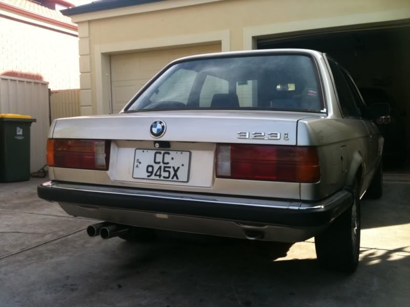

                As far as the exhaust goes, I ordered the Magnaflow 12198 Muffler so that should look much better than the current fart can. I like the current sound but it is a little loud and droney at cruise. I can't get it quiet even at 2000 rpm. It turns out lots of truck guys like this muffler. 3 inch inlet, dual 2.5 inch outlets. I just need to decide on what tips to throw on there. Since the early e30 rear valence doesn't have a slot for the exhaust pipes, I'm not sure.
                maybe something like these two. or dtm style tips.
