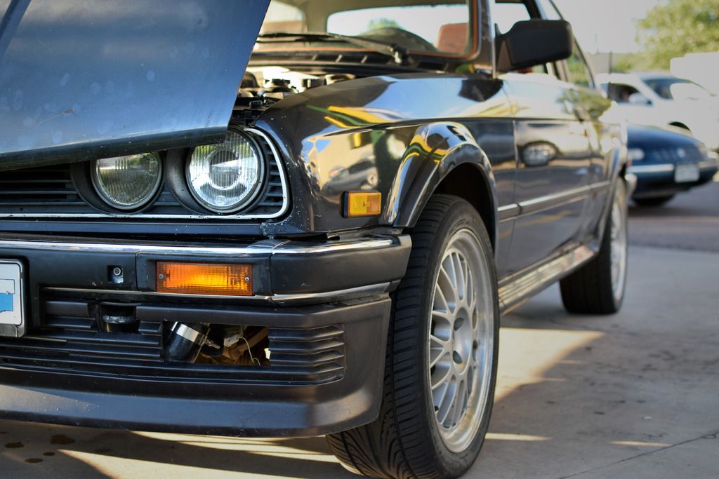

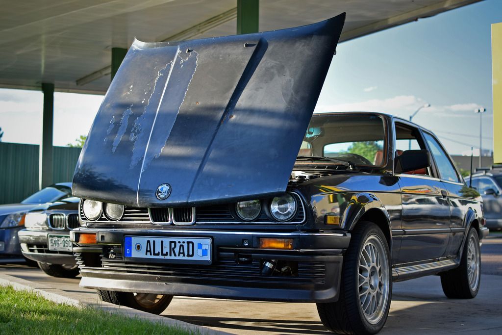

                                So back from the dead, I had lost my job which slowed down me spending money on this (or even touching it).
                                But I was able to make some progress on this thing. It had been sitting so long a layer of dust had settled on it.
                                First thing is first, i decided to swap the decent condition tail lights onto my s38 car to improve that thing, and that left me with a set of aftermarket lights that my buddy suggested I throw on this car. So I did, and had to order a few bulbs to make sure they were red and bright enough to be seen.
                                Next up I replaced the rusty front federalized fenders with a couple spares I picked up. I got diamond black metallic fenders from a 325ix so hopefully the paint would match and the flares would still fit without any modification. This ended up working as the early model flares fit on the late model fenders! The front looks so much better now without the orange markers and the back looks kind of ricey but kind matches the non conformist build style of the rest of the car.
                                No pictures of the rust on the old fenders but the driver side was rusted all the way through and looking pretty terrible. The side skirts covered most of it up.

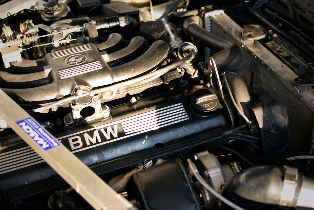

                                As for the engine, I installed the Good & Tight turbo manifold and wow is this a nice piece. I love the chrome finish and the fitment! I had to get a 44 mm wastegate to run this manifold so I bought a Tial MVR off craigslist. Then I went to install the downpipe and it was hitting the firewall. So i chopped the downpipe so I had it pointing at the ground and could atleast rid the engine bay of exhaust and run an oxygen sensor.
                                I drove it to a local shop with the open dump. I don't recommend this as it sounded like a diesel truck and I didn't even rev above 3000 rpm. I had them modify the old exhaust to fit, install the magnaflow 12198 3" inlet, dual 2.5" outlet, and install the chrome tips that I bought.
                                The tune was jacked up so I worked on that a bit today as I drove it around for the first time all year. And man is this thing fast. So much torque and then the turbo kicks in and you're moving. Anyway, still have to work on the tune, buy a new oil pressure sender cause mine broke, fix a ticking coming form the valvetrain, and she is ready to rock and roll.
                                Here are some pictures.
                                And a quick video
