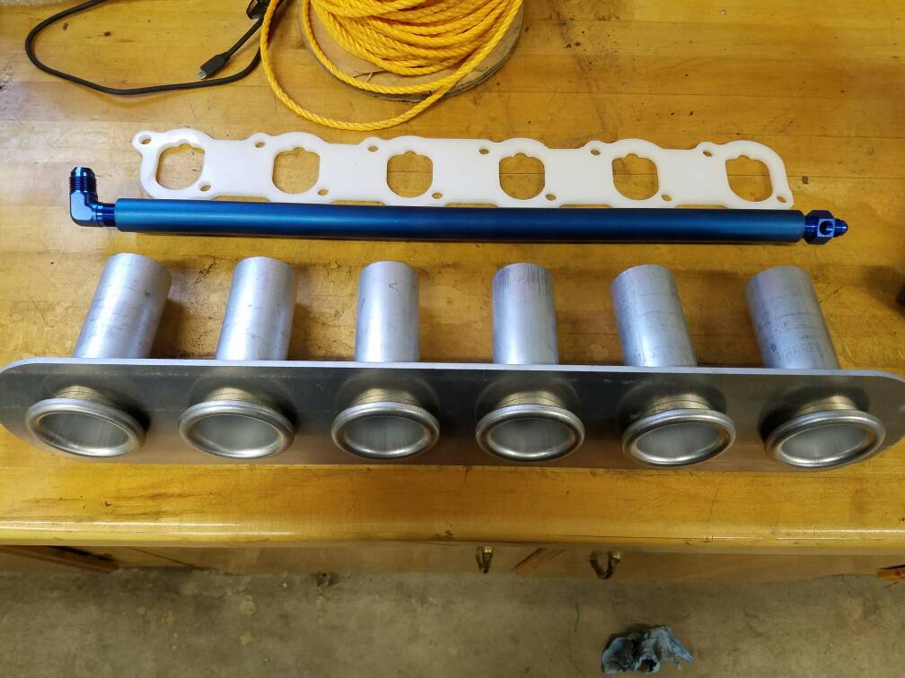

    Some parts arrived today and the ix is getting ready to be torn apart and getting some upgrades.
    My plan for the winter is to finish the e34 diff swap, build intake manifold, and redo the entire fuel system. Well that's my goal at least but we'll see how it goes.
