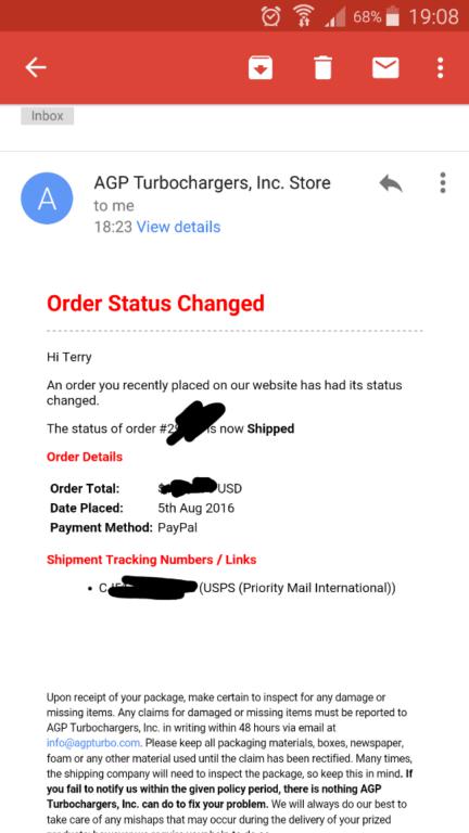

                              Pumped

                                Originally posted by Northern
                                Pumped
                                Specs? Or did I miss it in a previous post?
