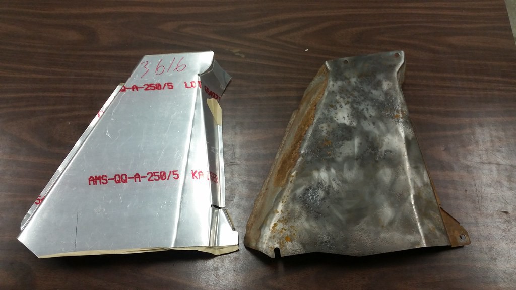

          Was the fuel leak from the spot weld or corrosion?
          Hope you can get the car sorted out soon. Have you though about just going standalone if you're trying to use a map sensor?
          That turnout quite well! I may have to do the same, I always hated how heavy that panel was. Some cars seem to have steel or aluminum heat center heat shield. I think it maybe and early early car vs late

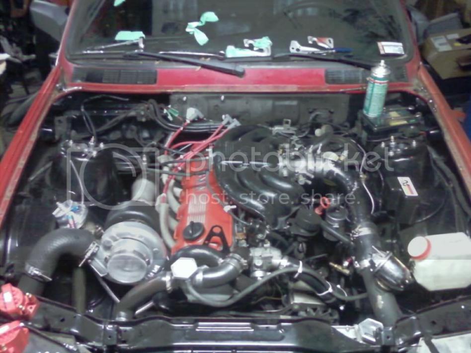

          Hah, this is great. A local at the time, I helped him build the car in his garage. The gold old days..

            It looks like it was a spot of corrosion. I couldn't find another early e39 M52 rail, so I ordered some injector hats and a clean looking OBD1 rail from socal, and then use my pitted OBD1 rail on my 4dr.

            That exhaust heat shield, I just bent that piece up from a masking tape template of the original, had to make some compromises on shape since I was using a brake for the bends.
            Funny to see that engine bay again, I'm probably going to eventually rebuild that turbo (again) for my other car.

                        I bought a Link E36X G4X from a member of this forum.
                        This will not go on this car, since I'm very happy with how MS41 is performing with the 41.3 beta flash, and I already have an EBC for boost control
                        I don't know if it will go on my 4-dr car this year, because I want to test Alpha-N, Speed Density emulation, and a bunch of other features of the MS41.3 flash, but I will find somewhere to use it eventually.
                        Also because I've found myself bringing this up a few times recently, here's a pic of a 413 DME (Top) vs a MS41 (Bottom) to show the difference in the connector.
                        Lastly a teaser pic.
