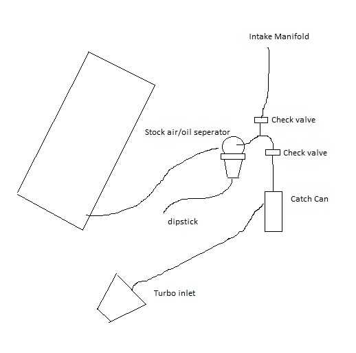

              Originally posted by Northern
              ^ That's the thread where the guy flipped the input and output and gutted the check valve. I'm going to give that a shot at some point down the road.
              This will be my setup once i put it back together:
              Check valve to manifold will open under vacuum, close when boosting.
              Check valve to catch can/turbo inlet will open under vacuum from the turbo inlet. It *should* be closed when the manifold is under vacuum as i expect greater vacuum from the manifold than the inlet when the throttle is closed.
              The extra catch can may be overkill, but i don't see it being an issue. Will probably have it drain back to the dipstick as well
                              I built my own version of this with check valves and a moroso catch can and it does work.
