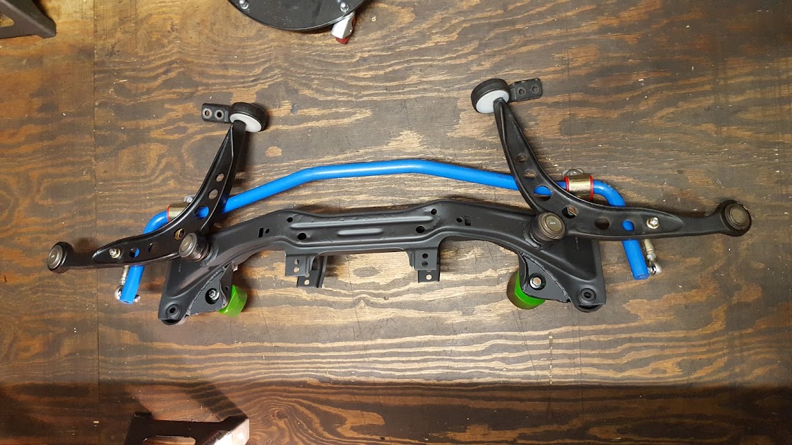

    This photo really helps show how much I cut out of the subframe and how much clearance I gained.
    Subframe assembly complete and ready for install

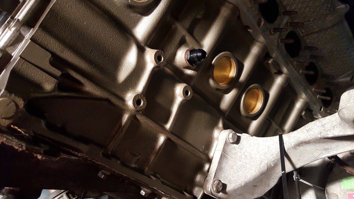

    This was the "cleanest" coolant block draining I have ever done, with exhaust amnifolds, subframe, swaybar, everything out of the way and it still went all over my arm, floor, side of engine. Never again
    First an hose end I have ever assembled. I did the first with a vague idea of what I was doing... it was a PITA. Then I watched a youtube video, threw out the first try and the second time was flawless. Should've watched the video to begin with duh.
    Metric to AN adapter in the block
    Finished drain extension
    Installed

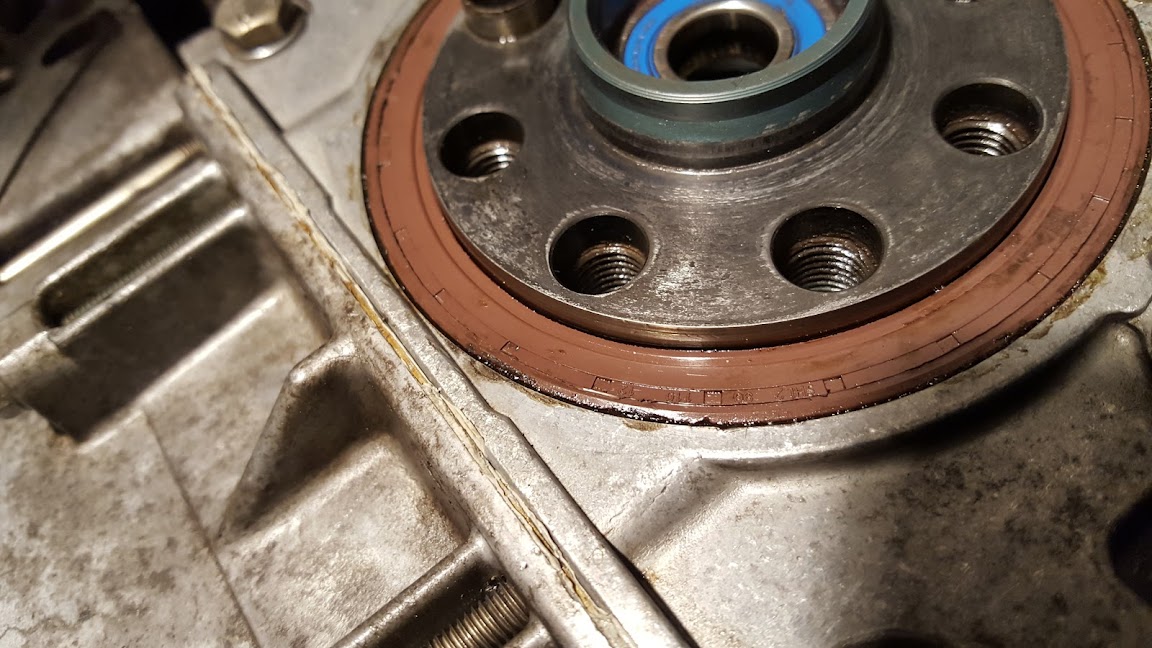

    Found something interesting. The rear main seal I installed was victor reinz. Dunno why the hell I did that when I assembled the motor. I don't trust VR for shit and it kinda looked like it was leaking.
    Looking at the joint between the seal and the crank its wet. It was more apparent before I wiped it, but you can still kinda see.
    The corteco seal is a very different style without a spring loaded inner seal. We'll see how it holds up.

    And the subframe clearancing mission was a complete success!! Not bad for eyeballing it when I cut it up. I have plenty of space now to remove/install the merge section without having to unbolt the headers. You can also see where the drain extension lands just behind the swaybar.

        You should break in a clutch for 500 miles of light use and minimal slip. Clutch disk might have failed? Also direction of install matters on those. A shop installed it backwards on my brothers e36 and it friction welded itself to the trans. Had to pretty much destroy the trans to get it off.
        Also my koyorad had a very slow leak. It ended up being the drain plug was not fully tight, they don't tighten it before shipping.
              I know there's a 500 mile break-in, but I always understood that's for proper bedding in and mating of the surfaces, and that premature heavy use could cause glazing/slipping issues, but no risk of breaking something... I guess I'll know for sure when I pull it apart. I doubt the clutch disk broke; the vibration is also felt with the car standing still in neutral revving which points me to the flywheel/PP.
              And I definitely installed it correctly.
              And the koyorad is definitely leaking, not from the plug - it's tight.
                              There was a change at some point, BMW switched to one without the spring. Apparently if the seal with the spring wears enough, the spring can contact and gouge the crank. More good reason to do the rear main when you can.
