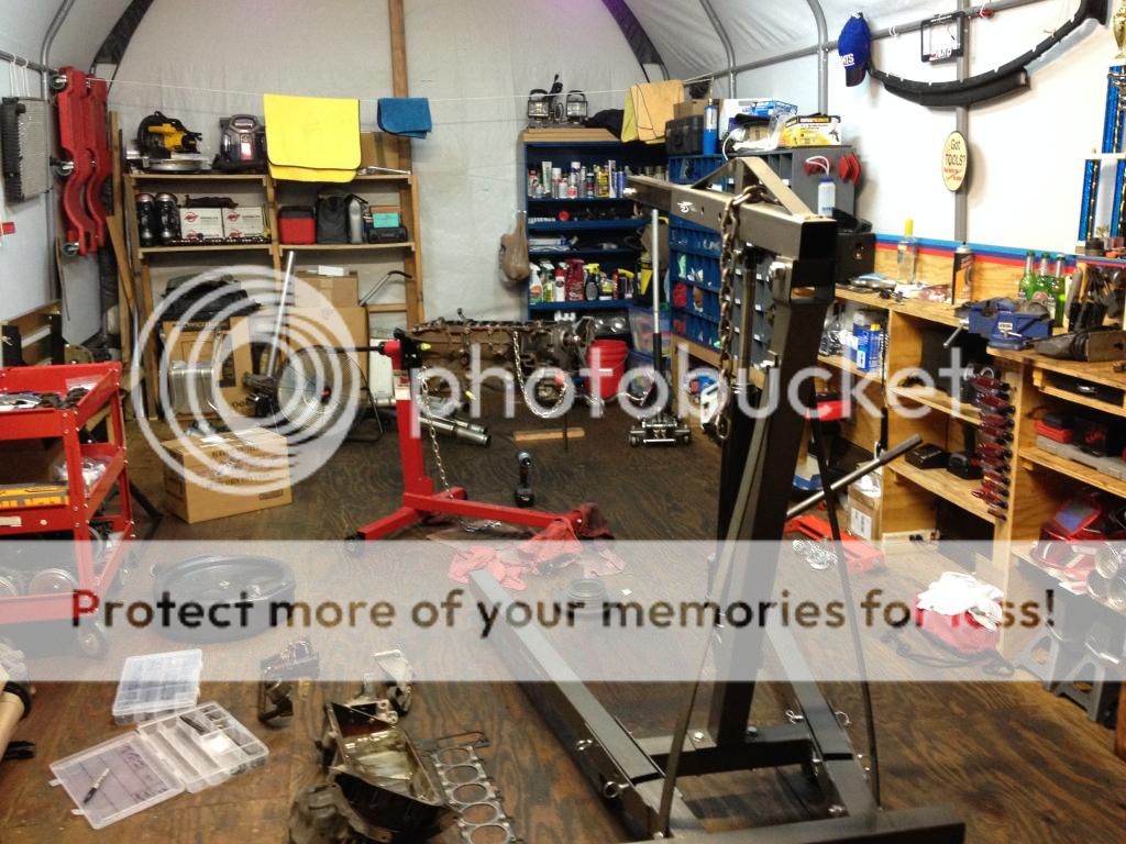

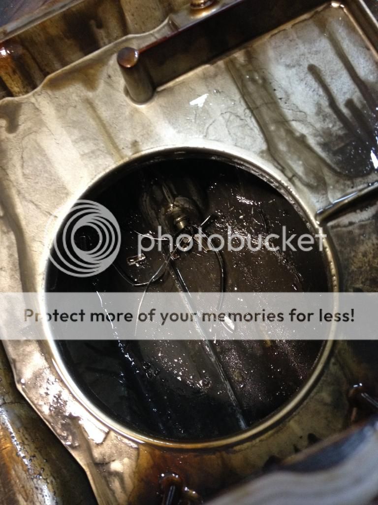

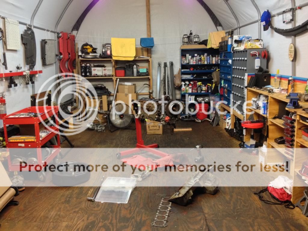

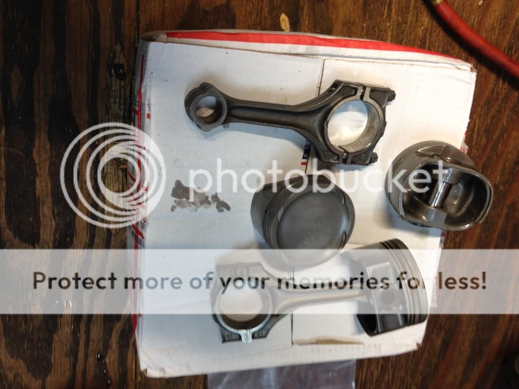

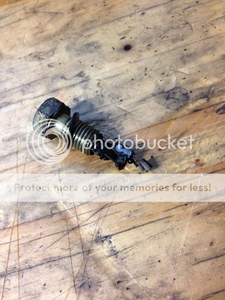

                  Back to work. Here are some older pictures of the dis-assembly of the original e36 m52 and some of the parts I bought ages ago in anticipation of the s52 build.
                  Block stripped
                  Pile of parts
                  s52 rods
                  And the money shot - I think that might have caused a little blow by
                  And here are some of the piston rings....
                  '89 325i OBD2 S52 BUILD THREAD
