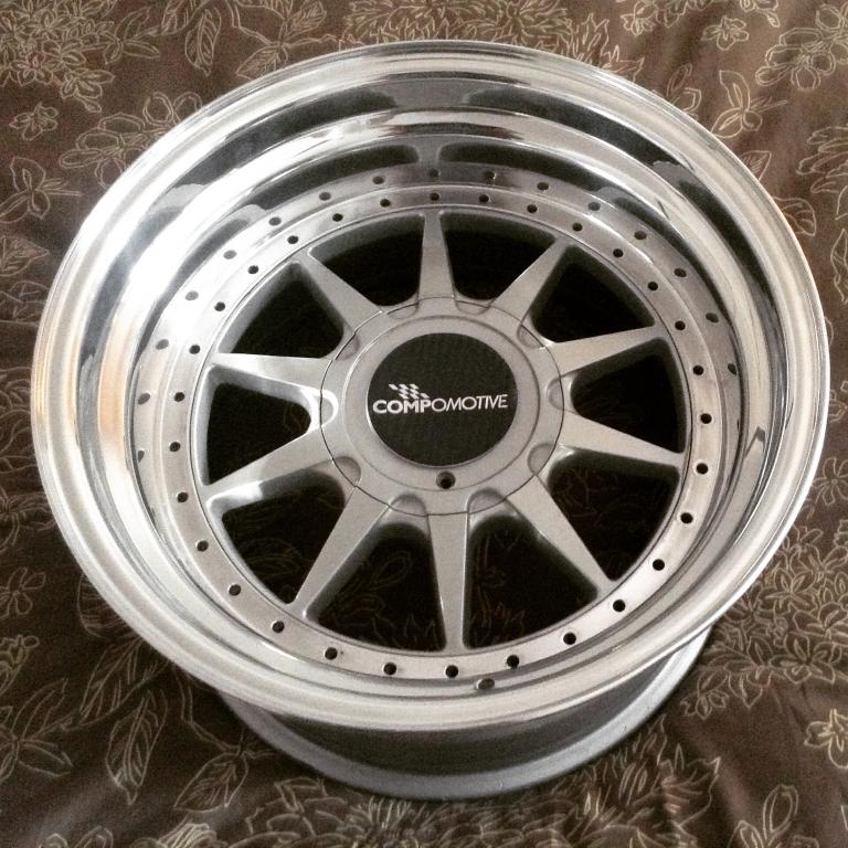

                  Originally posted by 2mAn
                  big thanks to E30_Pare for the photoshop!!
                  havent bought any wheels yet, but saw these and thought they would be a good choice
                  .....I have these (not my car, but the wheels I own came from it)
