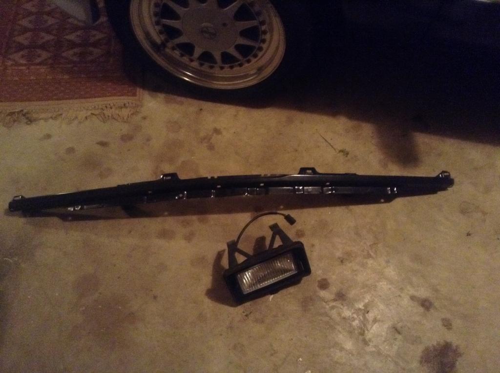

              Hartge 83-85 front airdam install DIY
              This airdam will actually fit on any <<<1988 e30, it was however designed for and is period correct For 82-85 "euro" models.
              That being said, if you are conveting the North American model, "euro" bumpers,brackets, 82-85 foglights&brackets will be needed. Your metal valance can be cut to fit or you can still buy part # 41331884353.
              If you have an 85-87 "euro" model you will still need the foglight brackets only,
              You could cut the valance but in this case I recommend selling it and buy #41331884353

                The car in these pics is a 87 jspec ("euro") model. Fitment was started prior to
                receiving the new upper valance piece.
                #41331884353. Upper valance
                #63171370783 foglight bracket

                      Basically all the tools & hardware you will need:
                      Drill & 1/4" bit & small pilot bit
                      1 or 2 clamps
                      4 nuts & bolts
                      Asst washers & fender washers
                      (Something to put under valance to get it to the right height/ or a friend to give you a hand)
                      Dremmel & accessories is also very handy ( optional)

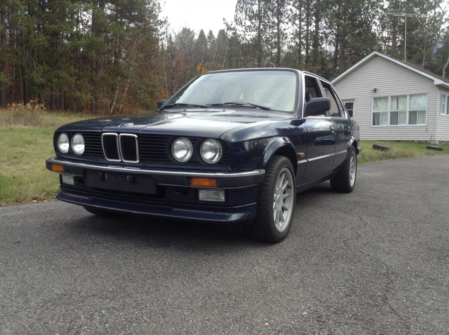

                                h26 spoiler on:)
                                Well, spent the day getting the spoiler on....here is what I learned in the process.
                                1985 euro 323i is the car I have with hartge conversion parts:)
                                First, read Barron's post above!! It is very helpful and I used the same tools...
                                Second be sure the euro brake ducts are moved back out of the way, or the spoiler will not go on. also, be sure the black plastic surround for the radiator is removed.
                                Use a box or two or a friend to hold the spoiler in place. The spoiler will fall forward and it is a pain if you can not hold it in place.
                                I started on the driver side, because the spoiler fit very good on that side.
                                Put the clamp on, then the bumper bolt on and then the fender/spoiler screw, or bolt. It works much better that way. Then once you have the bolts on tighten down the spoiler, fender bolt and remove the bumper bolt. You now can move to the other side.
                                Now since my car had a low speed impact in the front the fender is off a little. Expect to 'make it fit' if your car's front end is not perfect.
                                Once you have both sides on you can check for clearance and make sure the fog lights are in correctly. They fit right behind the spoiler, not inside the spoiler.
                                Ok now it is time to take it all off and paint the spoiler. You can take it in to a shop, or for much less you can paint it with a rattle can. Since my car will be taken apart in the future and repainted...that is the plan for now, I just used a rattle can to see what the spoiler would look like in red:)
                                You will have paint that is very soft, so you can wait a few days and scrape the spoiler up when putting the euro bumper on , or you can do it in a few hours and scrape the paint up a bit when the bumper goes back on:).
                                I will touch up my paint later....
                                Now when putting the bumper back on you need some boxes to hold it up and be sure to connect the turn signals before you place the bumper all the way on.....it is really handy to have a second set of hands to get this done without bumping the spoiler.....not good to bump the spoiler, paint will come right off!!!:)
                                Make sure the side of the bumpers are lined up correctly or you will never get the bumper on right.
                                Now it is time to put the brake ducts back on and lower the car.....
                                Took me 6 hours to do this project....most of the time was for painting since you have to wait about 15 minutes between coats.
                                Only problem I had was the passenger side did not want to go on, and the brake ducts were in the way...oh and don't force the spoiler on....you will hear a crack and it all over!
                                Now a real spoiler is rubber type material and would go on much easier. If you have a real hartge h26 spoiler sitting around let me know:)
                                All and all the car looks better and now has all the parts expect the mono wiper that it had back in 1985. I used the paper work that came with the car to determine what needs to go back on the car.......next project rear exhaust tip:)

                                Painting time 3 hours later......
                                Looks ok, shop will do better but will cost about 500:)
                                bumper is ready to go on
                                Other side, note one bolt on!!! Don't forget to take the other one out!!
                                bumper on....well not tight
                                other side, my fog light bracket broke:(, so it does not fit right
                                Car on the ground and ready to go:)
                                enjoy
