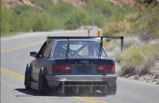

        Wow I havent been on here in almost 4 months, been super busy with work!! Here are a couple updates!
        New Rubber and Wheels. 17x9.75" with 255/40R17. Sold my other sets.
        First Test fit, see where I need to make room for Steering to full lock.
        With the fenders and bumper on, Need to raise the car a tiny bit.
        Camber Plates, but replacing springs and shocks, welding on a perch and adjustment sleeve soon.
        Koni Adjustables
        Rear Shot
        How she is sitting now waiting for me to start working on the suspension
        Also body mods coming too!

                awesome car, glad you went with koni. I run koni ground control, and once you dial them in they are awesome for money. Make sure you have enough travel, i am sure with the 17's you have more travel but doesn't hurt to check the compression. also maybe think about going full flat under body. It does wonders, creates down force with minimal drag.
                This dudes diffuser is set at 7-8 degrees

                  I do plan on doing more aero soon.
                  Done building my coilovers.
                  Flares on.
                  Strut bar on.
                  ride height
                  full compression
                  with the rollers, need to align it.
                  still finding a correct ride height for the front.

                              I'm running 255s square too - got any pictures of the sheet metal under the flare?
                              I've got rubbing at full lock even with rack stops. I'm debating taking a hammer to the firewall or 3D printing larger rack stops

                                Been watching your build for awhile now, this in one of the swapps i would consider doing. Thanks for the info.
                                My one question is, What does chopping the front fenders do for you. I am having a hard time seeing a aero advantage unless i am looking at it wrong.
