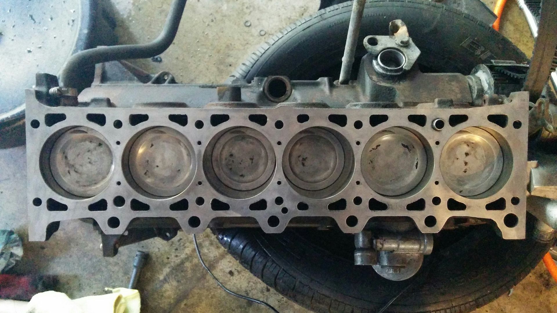

              Pic of the old engine internals, looks like its been burning some oil. My guess is valve seals since the compression was pretty solid across the board (165-180)
