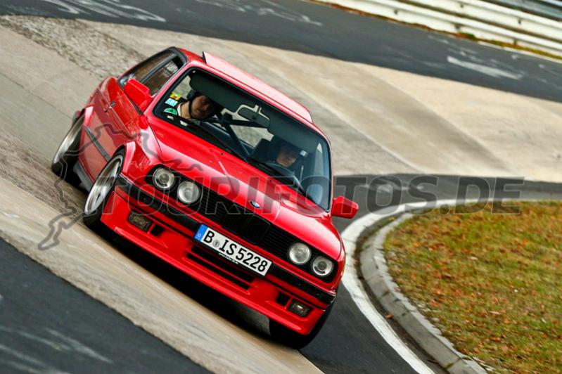

            Had one last opportunity to take the car to the nurburgring before winter so couldn't miss that!
            Car was really great fun to drive, But have some wrinkles to iron out. New tires will be a high priority for early next year. Probably Toyo R888.
