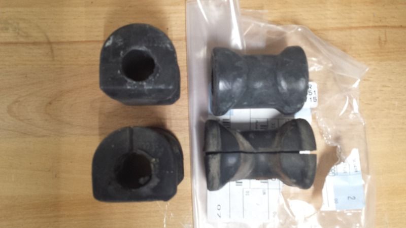

      Front sway bar bushings you see are in need of replacement. The hole has become elongated and the material itself is worn.
      New bushes up top. Smaller size and no longer cut. The replacements slide on.

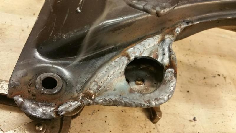

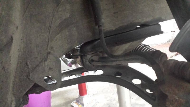

        Subframe separated now from that pesky driver side LCA. Best way to seperate the lollipop and LCAB from the LCA?
        Will arrange a day for the Subframe to be welded.

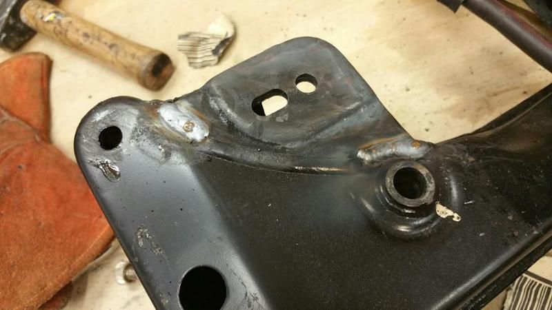

          Subframe is being welded and back to me sometime next week. I think he is going to extend what welds were not complete by the robotic welding during manufacture. Welder is an old time speed shop, American muscle guy. I trust his work and insight. Once it is back I will get it painted.
          Passenger side LCA has a torn boot and the thing is stuck to the strut assembly. Letting it soak with PB. Will pull off the lollipops and have E36 ones pressed in given my reading at RTSAuto. I am considering making the tools to do the LCA work. Put my money instead into new LCAs.

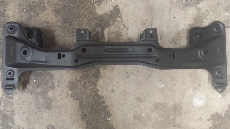

            Subframe in progress. Still needs cleaned up and painted:

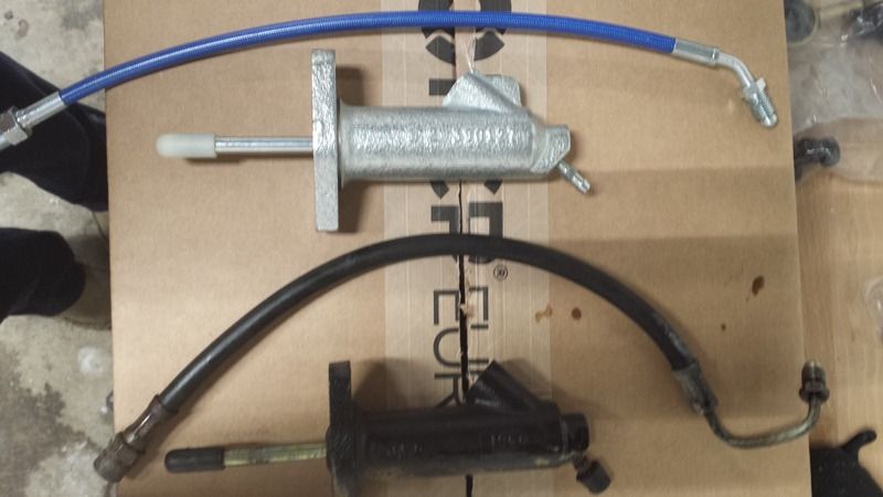

              Just ordered new clutch line to go with the new clutch slave and rebuilt transmission.

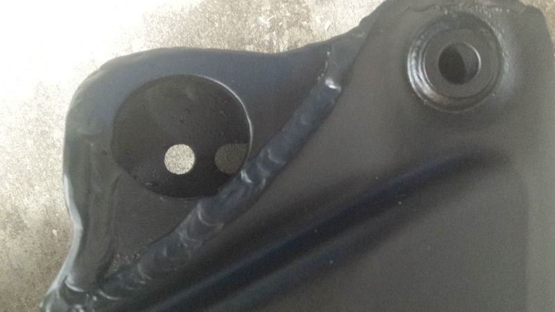

                        Welded and painted. The welding was continued on the reverse, too, where the factory left off in some places.

                          #132
                          The welds look good. I like the flat black paint.

                            #133
                            Thank you Raul. It turned out well. A local shop quoted at least $200 to weld in the reinforcements. Found a local guy from another forum I routine, quick barter and we were in business. Everything I am touching on the front is getting cleaned and painted. The flat black Krylon can I have paints really well.

                            In it is the UUC clutch line. My original slave and line were not causing issues but I felt better spending the money and time now to replace. When the M30 goes in, I want to have a well put together car. I also don't want to contend with the motor for space.
                            Old and new:

                            Big problem now is the old LCA spindle which attaches to the strut assembly is seized. I am working on trying to free it. Tried heat, PB for days, banging from the top, hammering it from the bottom... really hope I don't need to fetch one from the junkyard....
